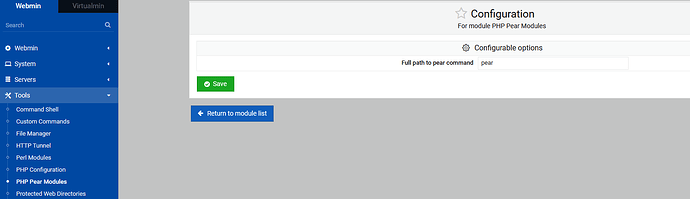

However, the PHP Pear module for Webmin now claims it is not configured correctly. I reinstalled php-pear, but this reinstalled PHP 8.0 along with it. I uninstalled the 8.0 version, and I can see php82-php-pear 1.10.13-5.el9.remi installed, but it looks like the path to Pear in the Webmin module is not correct. What should the path be, for PHP 8.2?

webmin doesn’t show a full path. So it sound like it not in the location of the PATH.

Added the latter path to the module, and it’s picking it up now.
