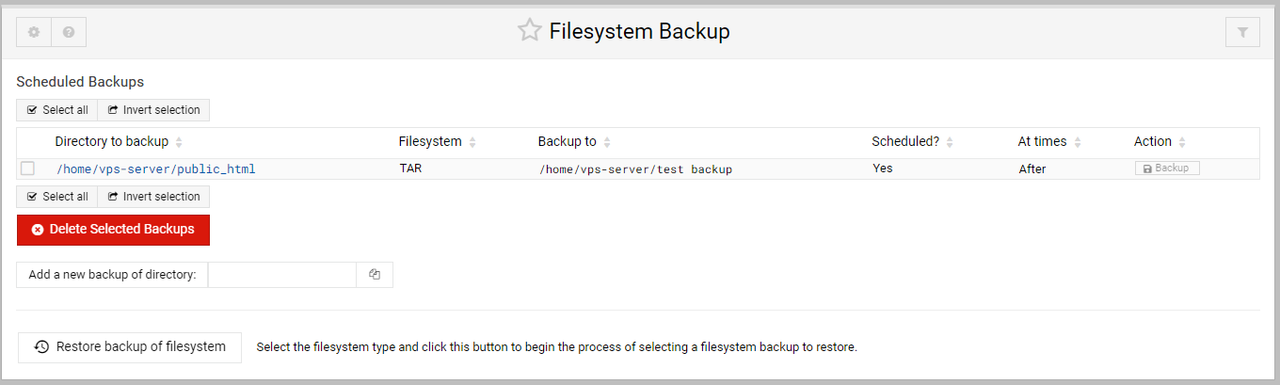

Ηello. I’m trying to set up the backup and I get the following error in my email. What to do?? A help please…
Failed to run on this server : Fast RPC mode must be enabled for copies to work

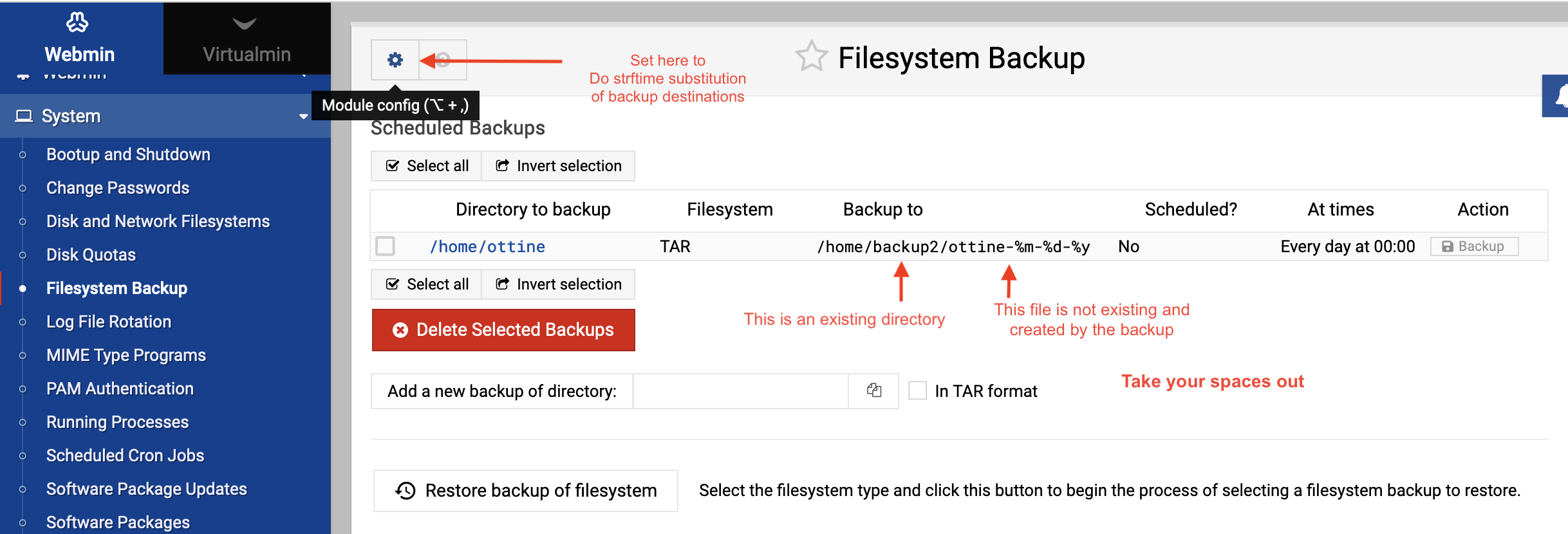

@dimgr you need to add a lot more info including
I am not an expert, newbie myself, but 2 things I have noticed that might cause issue:
/home/vps-server/test backup has a space in the file pathyou have a space in the backup name,or am I reading that wrong
test backup I have named the folder for the backup. Shouldn’t the folder name be empty??

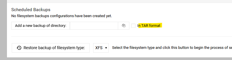

I made it. but can I have backup folders and files and not a .tar file???
