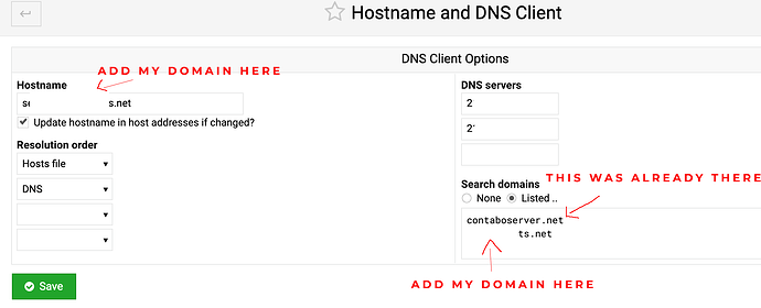

Here is what i did
Do i have to remove the search domain what was already there?

Subdomain, not domain.
The hostname should be a subdomain always, so in the box marked “Add my domain here” in the image above, it should be subdomain and not domain.
i.e. virtualmin.mydomain.com

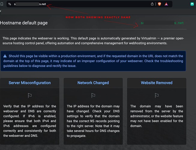

I think everything is fine now :slight_smile: both area showing the same host name now. i was able to log into my control panel using the same name with the port.
Eg. server.mydomain.net:10000
Just want to thank you all for your kind support :grinning:
