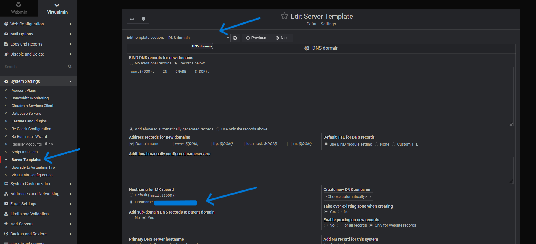

Hostname for MX record has Hostname ticked and the server hostname that the server and postfix uses entered in the field.
Problem is when the DNS record is created, it defaults to mail.domain.tld for the MX record instead of the hostname.

The section highlighted in the image is where you can enter your hostname in place of using mail.domain.tld
Ok, so the servers hostname (not the vrtualserver) is not taking.
