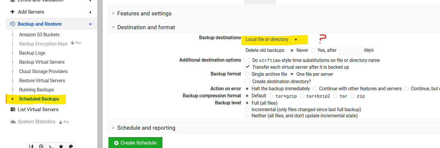

This is probably something really simple but I just can’t see it. I am trying to set up a incremental backup. When I set up the parameters using the Backup Virtual Servers option I can select where the backup should go, but I can’t schedule the backup.
If I go to Scheduled backups I have no option to choose a location.
What am I doing wrong?
I think I figured it out but it is a bit awkward.
If I select another option such as FTP and the fields for that get displayed, If I then go back and select Local File/Dir the field for the directory and file name is displayed.
You actually have to make a different selection first. Just selecting the Local file or directory option will not display the field.
I would have thought that the field should be displayed with the default setting of Local file or directory and not require the display to change in order to be come visible.

Figured it out.
It does a complete copy (no incremental from what I can see) Don’t know how I missed it previously.
I assume the checkbox ‘In TAR format’ is OS dependant?
Backup & Restore -> Scheduled Backups -> Schedule and reporting
