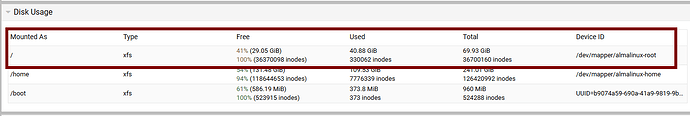

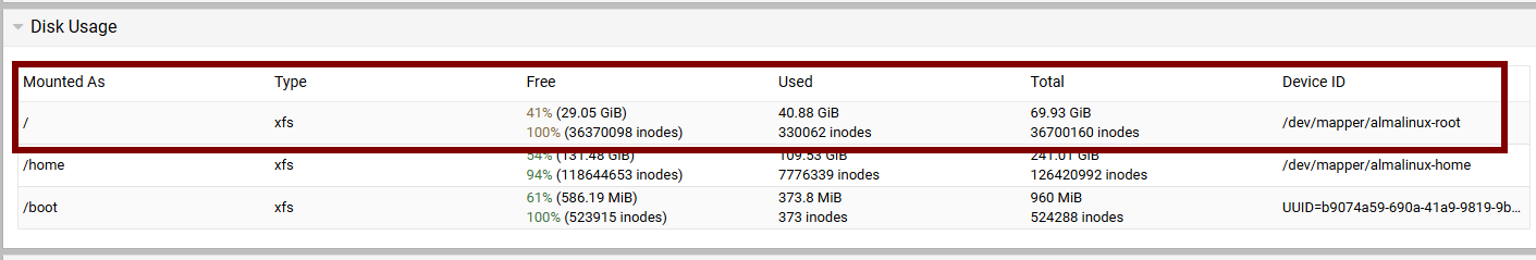

my root partition (/) fills up regularly for very short periodes of time (< 1 minute). This temporarily causes issues with my database (for instance)
/home and /boot are fine. it’s only the root-partition (see screenshot). it goes from 40% free space to 0and back up to 40% in a matter of a few minutes.

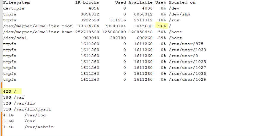

ok so I’ve setup a small cron-script to log some disk size every minute.
At this point the almalinux-root-disk is 96% full
but the root dir (/) is only using 42 GB (roughly 50%)
What am I missing here?
