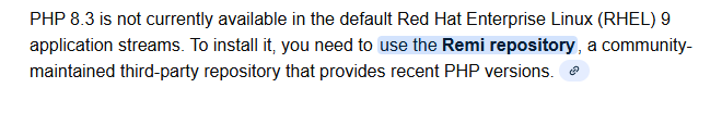

Thanks for sharing but this is a third party repo.
I posted a link from the Documentation. All you have to do is follow the instructions. The Remi repos is as good as it gets. Read the documentation.
