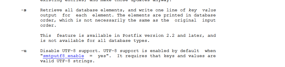

OK found the command
postmap -s virtual > virtual.txt
try that, please backup your virtual.db first though.

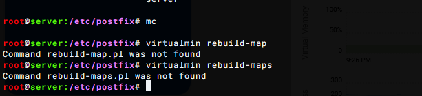

BTW I don’t think thats a valid command, I can’t see it in the list of commands and if I run it it errors.
where did you find it?
Maybe its call rebuild-maps and not rebuild-map
I tried both, I see no docs on it either.
Does this help? It mentions “virtualmin-config-system -i Postfix”
Yeah, that not the command, I think it maybe a AI solution that doesn’t exist.
