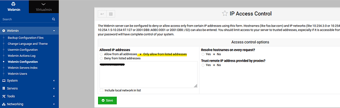

Is this for security reasons? I just restrict to my IP, no one else can access. or 2FA.
