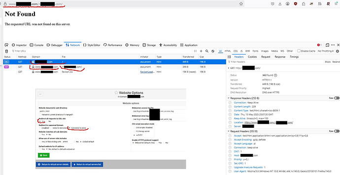

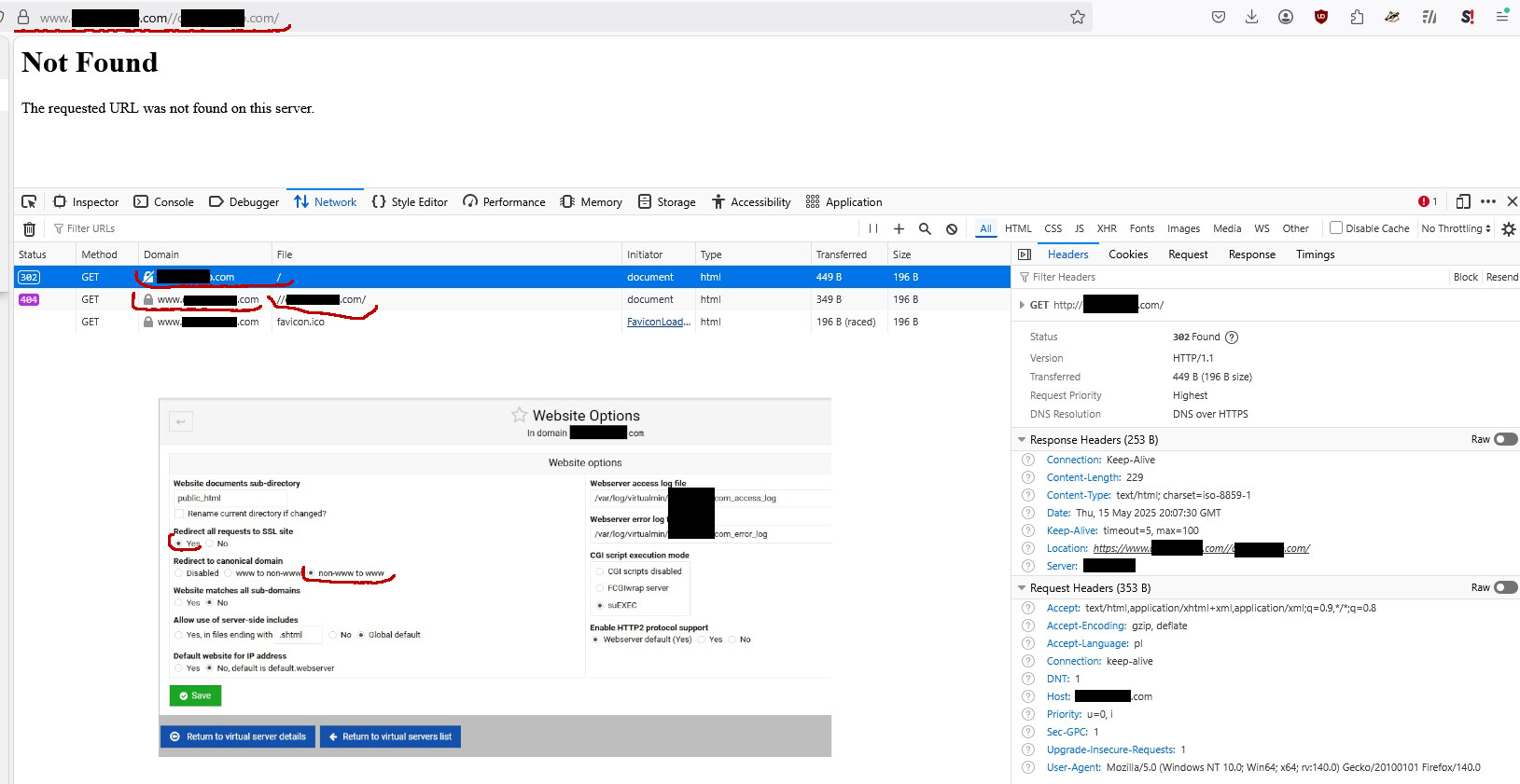

The Combined options for “Redirect all requests to SSL site” => “Yes”, and “Redirect to canonical domain” => “non-www to www” causing wrong redirects as follow:
Navigating to:
http : / / DOMAIN . com /
is redirecting 302 to:
https : / / www. DOMAIN . com // DOMAIN . com
The issue is, the DOMAIN name is added to the URL file path, together with a slash prefix.
The URL Path should remain as a single slash “/”.
Expected behavior:
Navigating to:
http : / / DOMAIN.com /
https :// www . DOMAIN . com /

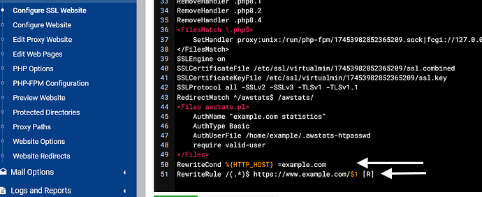

Works fine on my system, I have Apache.

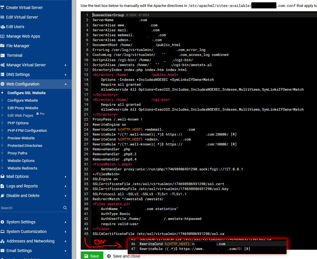

its creates 2 lines in the directives.
I’m using Apache, issue still exists for a real domain, that “example.com” from @stefan1959 is not accurate as the issue happens on a real scenario not just only for a non-existing domain like “example.com” and just directive-checking.
Here are my directives for that domain (nothing edited manually):
When Redirect non-www to www is On there are two lines added, however on a real domain available via web browser the issue persist as described earlier, directives looks good but the real behavior is different.
I did test on a real domain, so not sure why say its not accurate, your screen looks the same to mine, maybe me eyesight is getting bad. (I did nothing manually)
I reduplicated it on a example.com so I could screenshot it.

Nevertheless, there’s nothing in logs as the issue didn’t broke anything, it just redirects to the wrong path, so in the logs there are just 302 redirects to the wrong path, nothing more nothing less, no errors.
