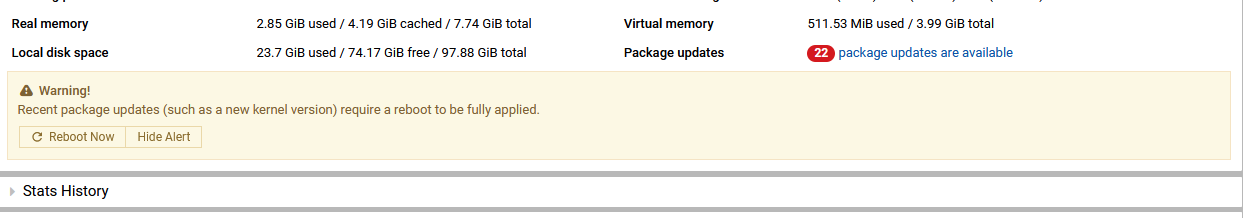

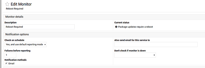

I have a Reboot Required monitor setup so I get an email when the server requires a reboot. However I am having an issue with not getting the email.
The monitor is configured to send an email only when it gores down, not to constantly send emails when it is down, however this later option does work.

This monitor just reflects the system status. It is the same as the warning message that is displayed as well. I have not set this name.
I have left the name as default
