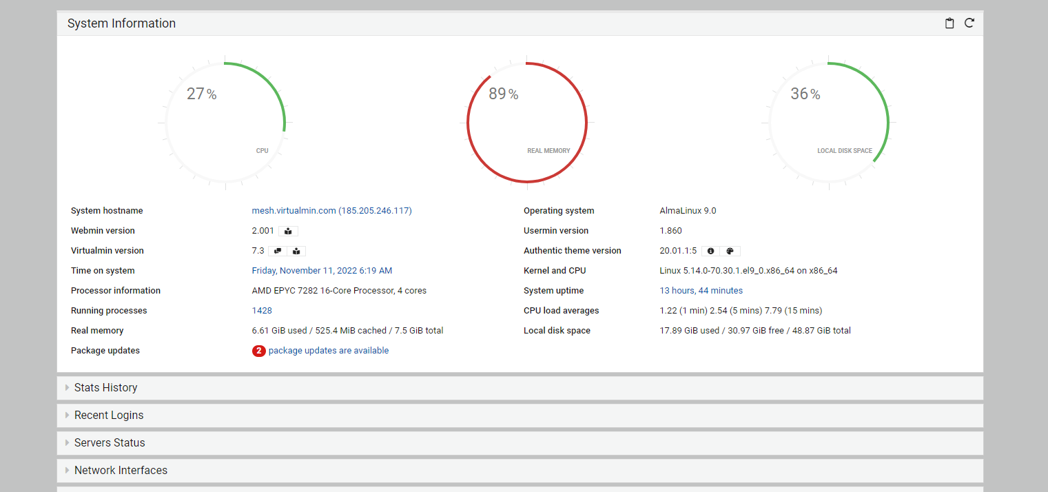

Real Memory very high above 88% causing error establishing database
OS type and version AlmaLinux 9.0
Webmin version 2.001
Usermin version 1.860
Virtualmin version 7.3
Theme version 20.01.1:5
Please I need help with my system.
Just 3 days ago I started experiencing database error and this happens often and when I restart system it goes away.
Please what can be the cause of this issue.
Currently my sites are offline and can only get back when I restart the system.
Meanwhile I only have 4 websites on the server which is too little to cause this issue.
Any guide for me?
Below I attached screenshots.
I saw a suggestion that says to run free -m but when I checked the result below shows there is no space for swap.
