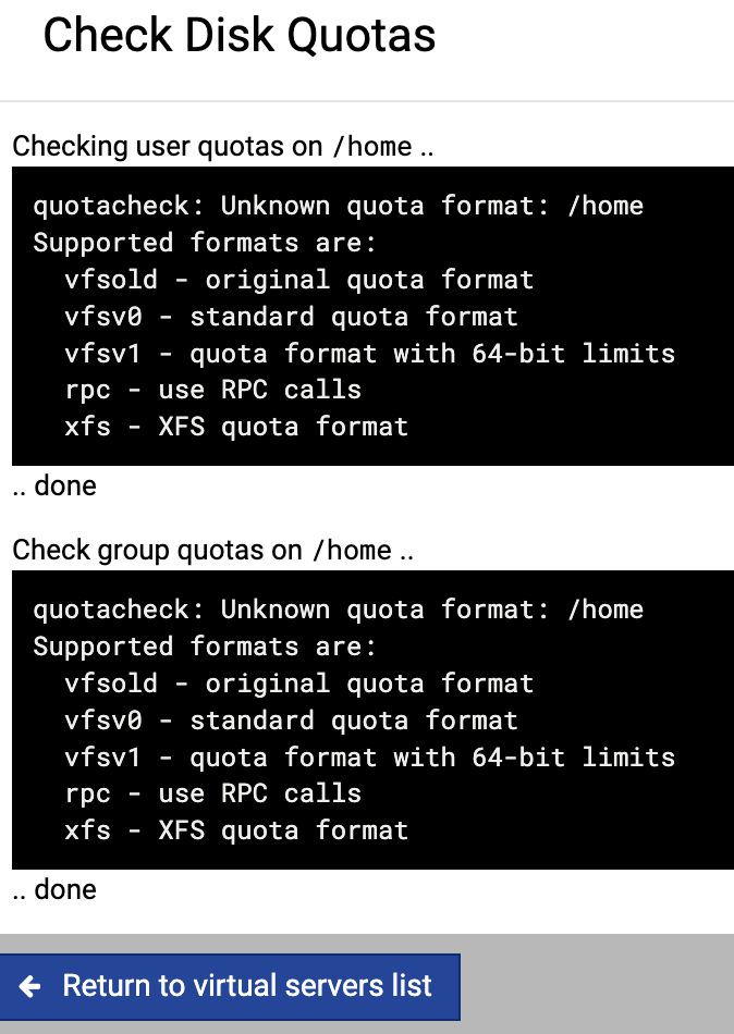

However, Check Disk Quotas in Virtualmin always reports:
quotacheck: Unknown quota format: /home
The root cause is that Webmin’s quota module runs quotacheck -u -g without specifying the format. When using native ext4 quota, there are no aquota.* files on disk, so quotacheck cannot auto-detect the format and fails.
Suggested fix: before running quotacheck, detect whether the filesystem has native quota enabled in the superblock (e.g. tune2fs -l <device> | grep -q quota) and skip quotacheck entirely in that case — it’s not needed for native ext4 quota.

Quota is working fine. The quotaon -p /home reports is on and repquota -a shows correct data for all users. The only issue is that quotacheck -u -g (called by Webmin during “Check Disk Quotas”) cannot auto-detect this format when no aquota.* files exist, and reports Unknown quota format.
Happy to provide any additional info that would help track it.
