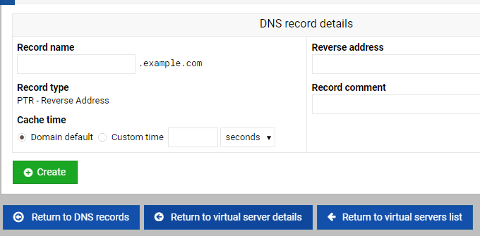

On the page “Create DNS Record” section “DNS record details”
When creating, I get an error:
Failed to save DNS record : Record name contains invalid characters
When I add “mail” in the “Record name” field, I get a different error:
Failed to save DNS record : Value must be an DNS name and end with a dot
I submitted an empty form with only a valid IPv4 in the “Reverse address” field.
Note: a PTR record should also accept a valid IPv6.
See also: Create DNS Record PTR

@Joe that is in the input field; the domain (note: with dot by the way) is listed behind the input field and is uneditable. I would assume that the CGI script will make “mail” from the input field into a proper “mail.domain.tld.” PTR record.

As I said, in the GUI, the dot is not there + I get the error no matter what I try to enter in this form.

So this is somewhat different. Though I’m not sure what this form does or expects, I’ve never actually used it. It’s kind of misleading about how a PTR record works. PTR records aren’t part of a forward zone (e.g. example.com) so it’s misleading that it presents it as such, I think. Though, I think I get what it’s trying to do, I’m worried it’s gonna lead people to think you can have a different one for every zone on one IP, which isn’t possible.
I’m going to have to poke around. Maybe @Ilia or @Jamie has insight on what this is expecting here. To me, this form doesn’t actually make sense, so I’m kinda guessing.
There is an odd case in which a PTR record can be in a forward zone, if your ISP or hosting compare creates a CNAME in a reverse zone pointing to it. This is a super-rare case though that you almost certainly don’t want to use…
