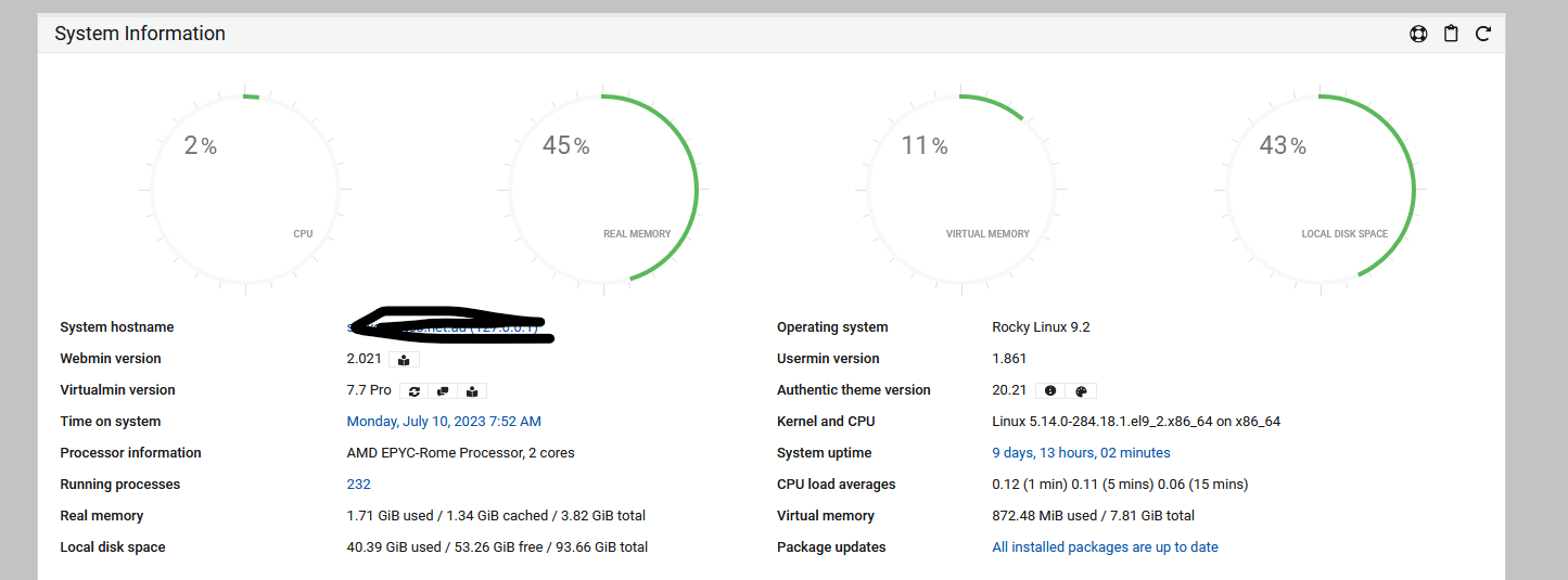

4G of real memory isn’t a lot. How much swap space do you have?
Barely enough to run nginx let alone the rest of the basic system processes. Didn’t Virtualmin cough :scream: during install
I run on 4Gig no problem(apache). Maybe OP has the virus scanner running, that can take up to 2gig ram.
I have 16 virtual servers.
does nginx need more ram? VM should easily install on 1G.
