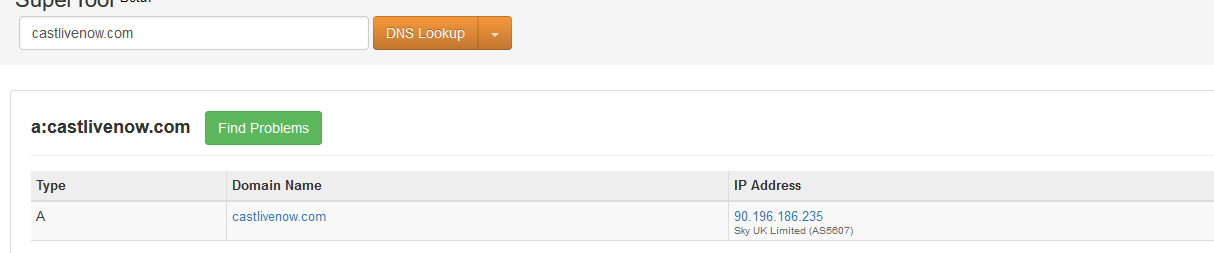

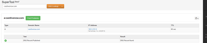

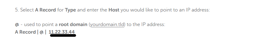

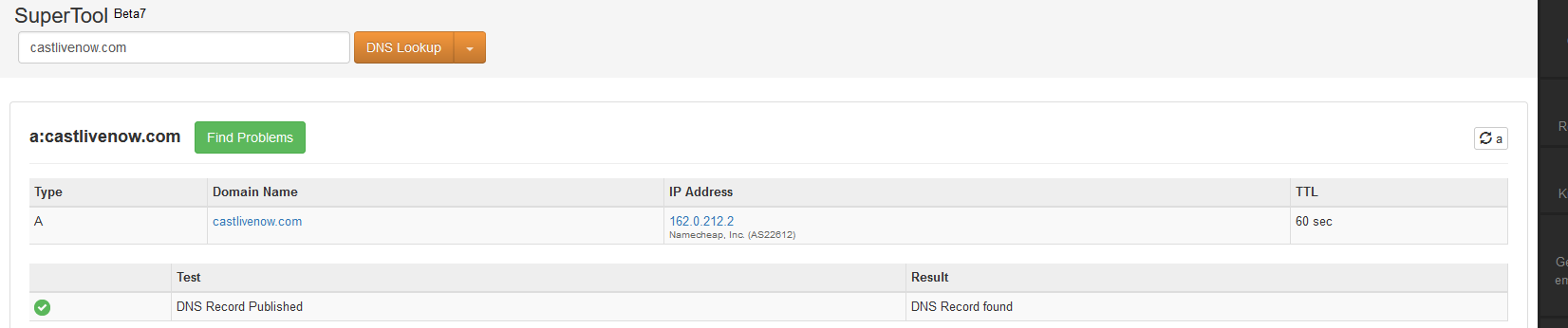

where this other ip coming from?
my domain and dns is with namecheap

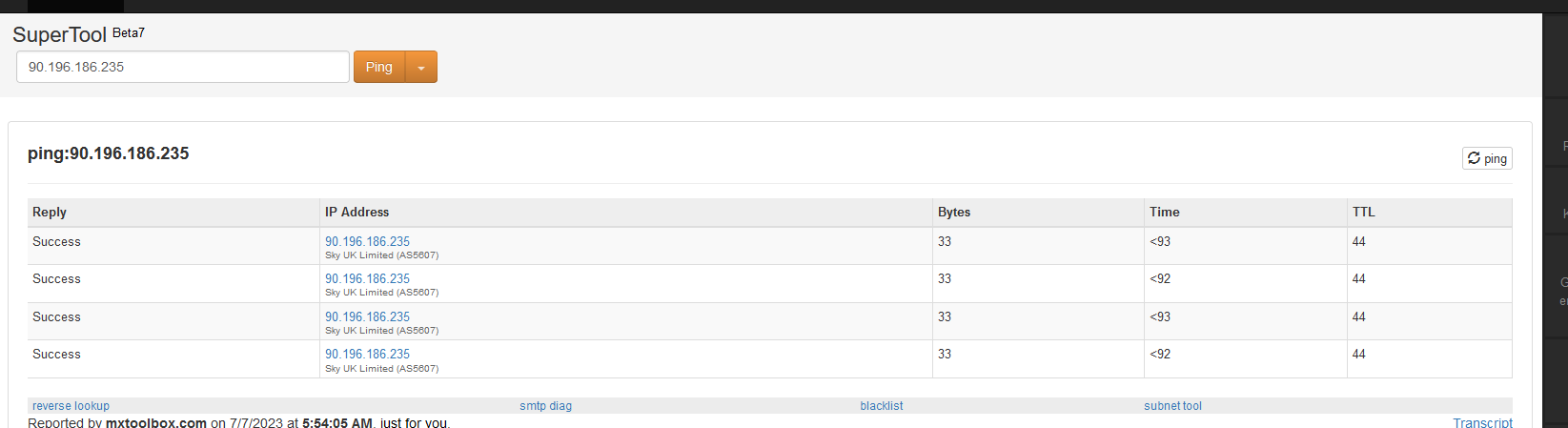

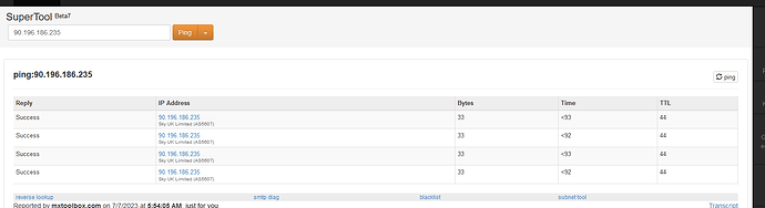

A is pointing incorrectly, edit the A record to the one I pinged.

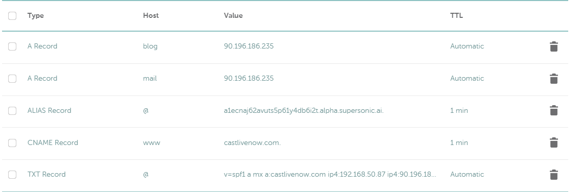

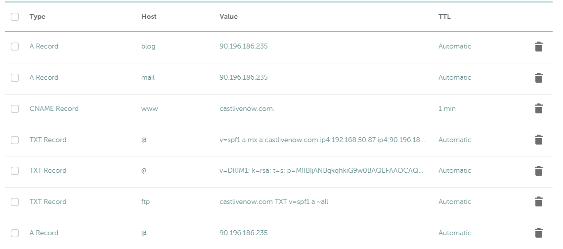

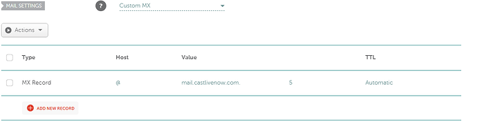

this is what shows up on my records on namecheap

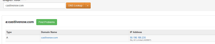

I see no A record for your domain. like
A Record @ 90.196.186.235
ok how do i solve the issue please
use your IP
I see you did it
is this correct now

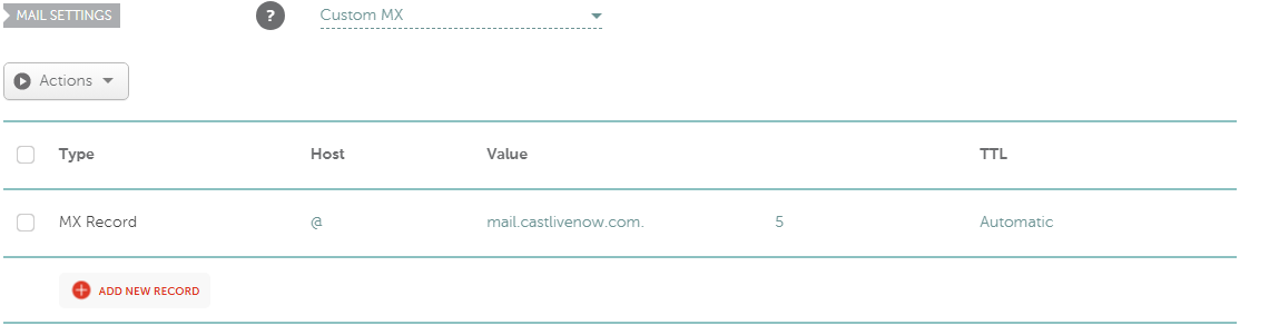

You need a MX record (type) @ (Host) mail.castlivenow.com (value)
yes i have that too its at the bottom

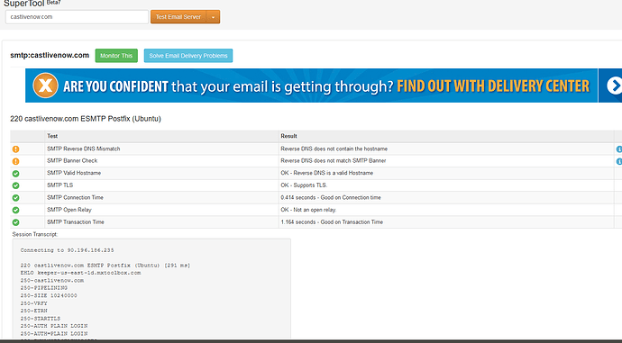

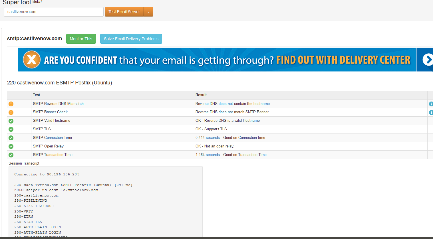

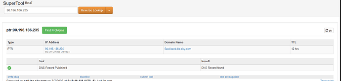

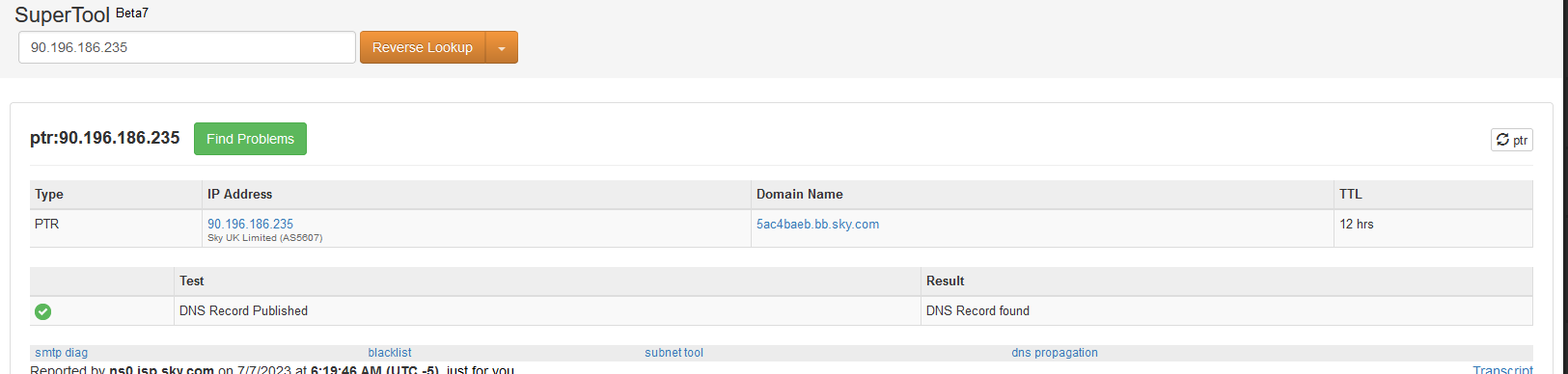

how do i resolve the smtp mismatch dns
You need to get Sky to point to something like mail.castlivenow.com
Good luck with that :slight_smile:
so i have to get in tounch with sky to ask them to setup a ptr record for my server
yep, the control that, see if you can send to a gmail account. Gmail will normal block if the PTR is wrong. But not sure if the block if you don’t have one or its not matching
ok i will contect them now
i have just contected sky and they cant help me with the ptr record issue so what do i do now
Not much with PTR as far as I know.
so how do i solve my connection issues then with the SMTP Reverse DNS Mismatch
