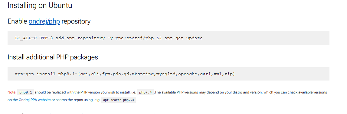

Looking again you need to install php curl to start with
Ah ! that is a separate problem.
PHP curl is not normally added. (at least on my VM) so you need to add it if not already done.
IT is a problem caused by some module in your web app that is asking for it in PHP.
Go to Virtualmin -> Web Configuration -> PHP Options then be sure you are using FPM execution mode. Then expand the PHP Information to reveal the modules loaded.
Is curl listed?

You are clearly asking for PHP curl module available in PHP and it is not there so you need to install it. You have identified the problem as not being Cron or PHP you just need to install the `curl module that your app is requiring.
and please edit the title of the topic to show the fact it has nothing to do with Webmin or Cron.
Nobody can tell you that it will definitely work with that change. But, we can all see it is currently not working and that is at least one of the problems that makes it not work.
