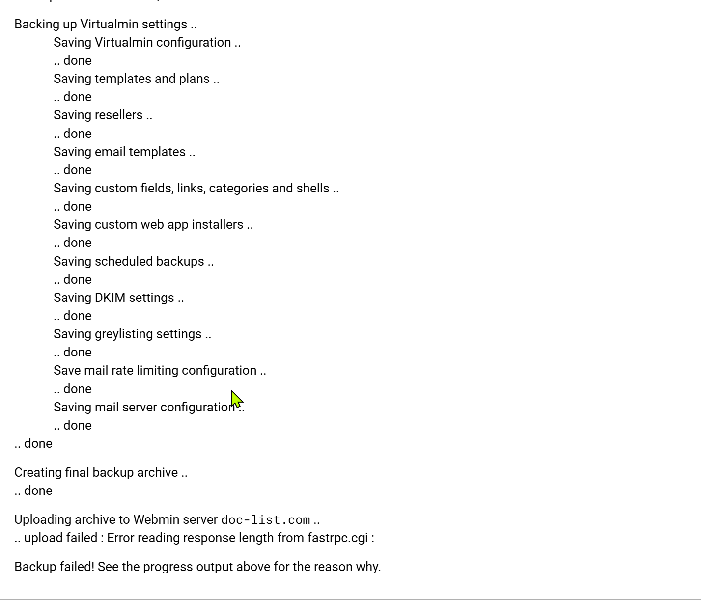

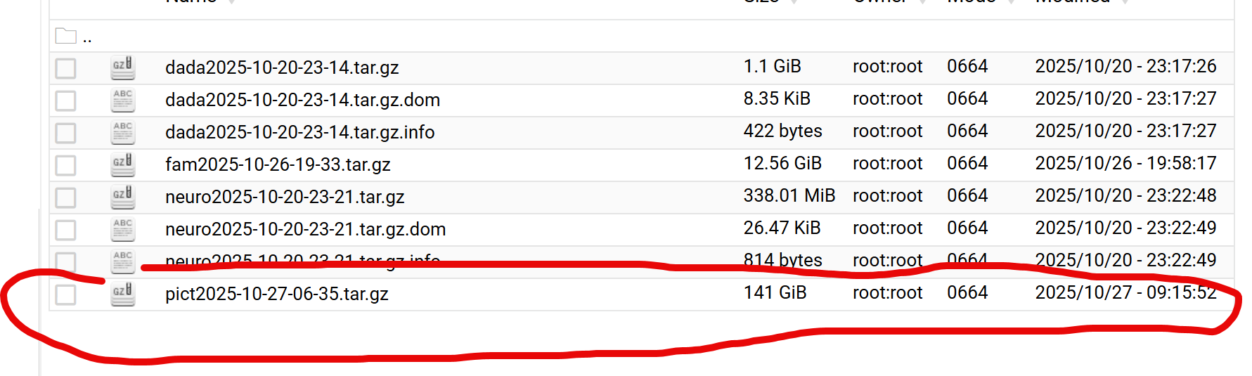

I went ahead and also did a backup of the 141 g virtual server and it also failed in the same way the 12.6 g job failed. Once again, the main "tar.gz’ file was downloaded to the destination server but the “.dom” and the “.info” files were not.
Output from the source server:

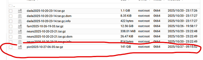

Files on destination server:

So, the large main backup file of 141GB was uploaded to the remote Webmin server, but not the small (.dom and .info) files?
Exactly. This was the same for both large files. The large main backup file was uploaded to the remote Webmin server but not the small files (.dom and .info).
