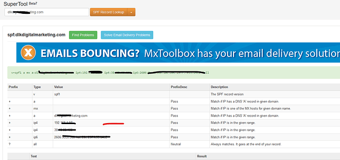

I can’t find A, MX, or SPF for your mail server in your DNS. Also, PTR is not set up for your IP. That will severely affect deliverability.

I’m using the nameserver that is on Virtualmin so I would think that those things would be set up when Virtualmin created the nameserver. I remember going into the parameters and specifically requesting SPF to be enabled.

spf ok, you could drop the local ip though, but this is getting off topic

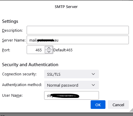

Try port 465
this is my thunderbird setting
