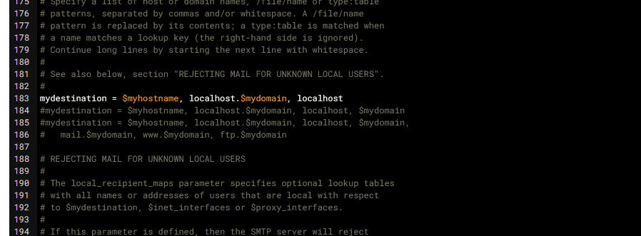

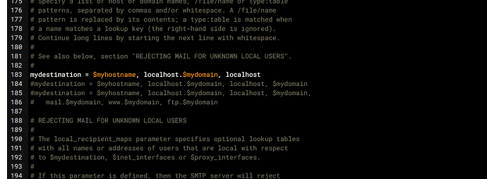

On my system myorigin is commented out and this is mydestination.
Have you edited the main.cf file?
That’s a real no no with virtualmin.
Is /etc/mailname a Ubuntu thing as I don’t have that file.
Don’t compare different OSes. It’s misleading.
We do not alter the way the OS does things like this. You should not expect a Virtualmin on Ubuntu system to look like a Virtualmin on EL system at the level of configuration files. We try very hard to use the OS as the OS developers intended.

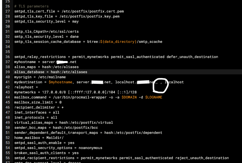

Just installed same OS with a spare domain I have and configuration looks the same as OP with a slight difference and I can’t see that causing a issue. 2 commas with a space between.
no loop issue.
