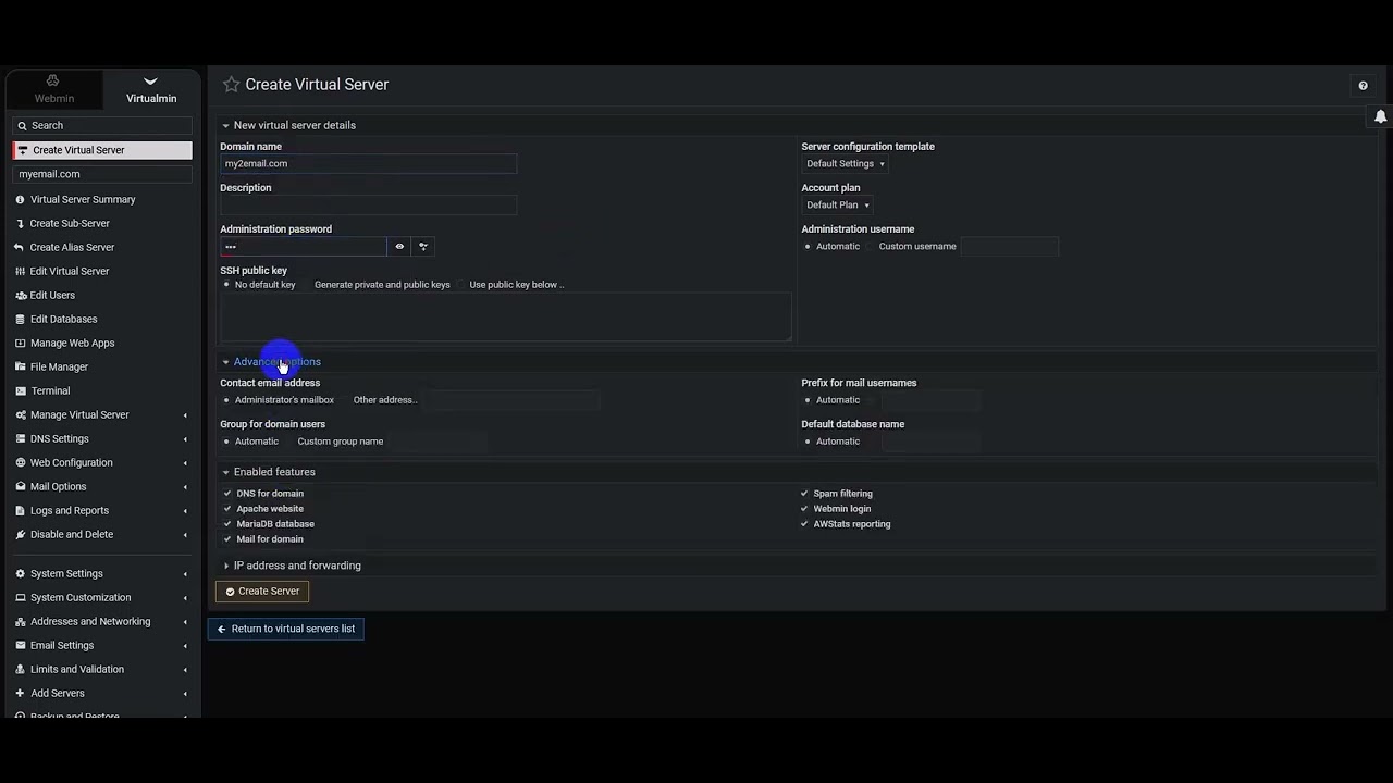

People usually judge others by what they themselves are or represent. I received a message from someone calling me a liar, shameful for someone so mature. Here’s a video where I show that Virtualmin’s global email sending limit didn’t work in my test, so I gave up on it. Better to do it manually.
This video is unlisted and will be forever.

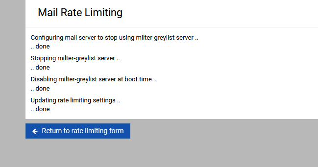

It does seem like a bug, turning it on and off, look like it uses milter-greylist, which is a worry as its not available in RHEL 10. I maybe wrong about milter-greylist, but I don’t see any changes in postfix.

Rate limits in Virtualmin are provided by a policy server (usually milter-greylist, I think, I don’t remember details, and it varies by OS and version), which is not involved in local sending. That’s a configuration choice, you can put it in the path for local mail delivery, too. Trickier to configure, though, as it then ends up applying to incoming mail, too.

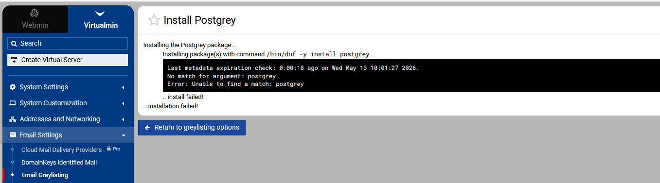

What OS, I just tried on Rocky 10 and still can’t install.

Sorry wrong service, I was thinking greylisting.
Rate limiting and milter-greylist was install.
Can milter-greylist be used for Email Greylist instead of postgrey?

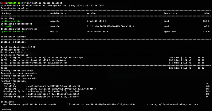

Duh, I completely forgot we didn’t have milter-greylist support until now! I spent today learning how to integrate it and just finished setting it up.
This PR adds proper support for milter-greylist, which we’ll include in the upcoming Virtualmin 8.2.0 release.
@Jamie, please take a look:
@stefan1959 If you’re willing to try it out now, apply the following patch:
webmin patch https://github.com/virtualmin/virtualmin-gpl/commit/b09ca65
