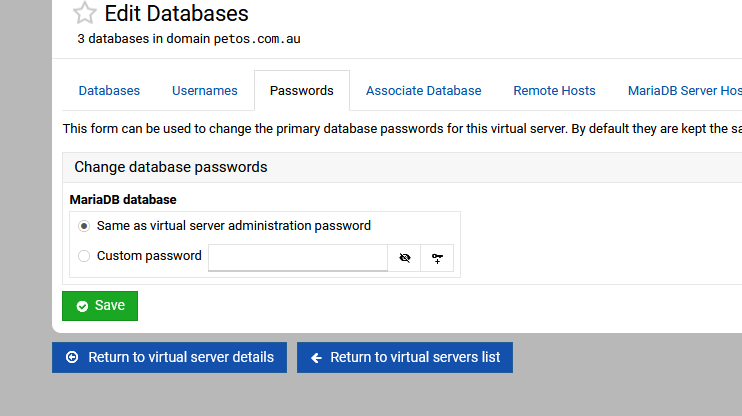

Could you try resetting the MariaDB password for the user of virtual server in question using the “Edit Databases” page? Would it work then?
That seems cause a different response, but the other domains is the password error.
If I change back to default the password error returns
I tried changing username no difference,
Same issue when custom user and password.

I tried resetting the MariaDB password for the user of the virtual server in question using the “Edit Databases” page.

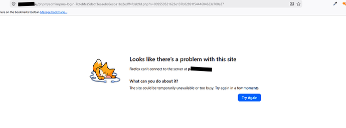

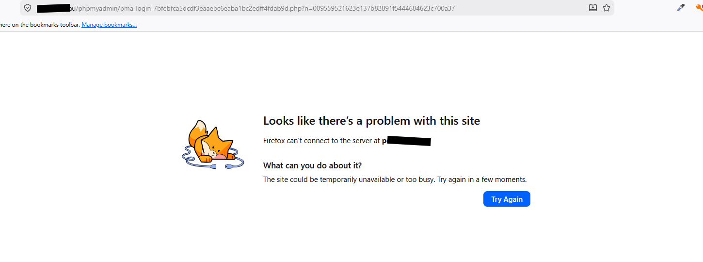

https://website.com/phpmyadmin/pma-login-26be638447416078819210953a156232fc47099d.php?n=a6d5ecb1e2caadfeec0bd4fcafbda8badfa3de7f
502 Bad Gateway
