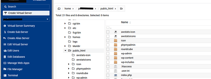

i have it installed now as a ‘web app’ with folder ’ /phpmyadmin’ , but dont see it in any of the public_html folders
can we install as a sub-folder in the public_html, then use directory restriction ?
but adding to restricted access, and addign a user, still does not make access restricted ?
Never had that happen, you should see a folder for it.

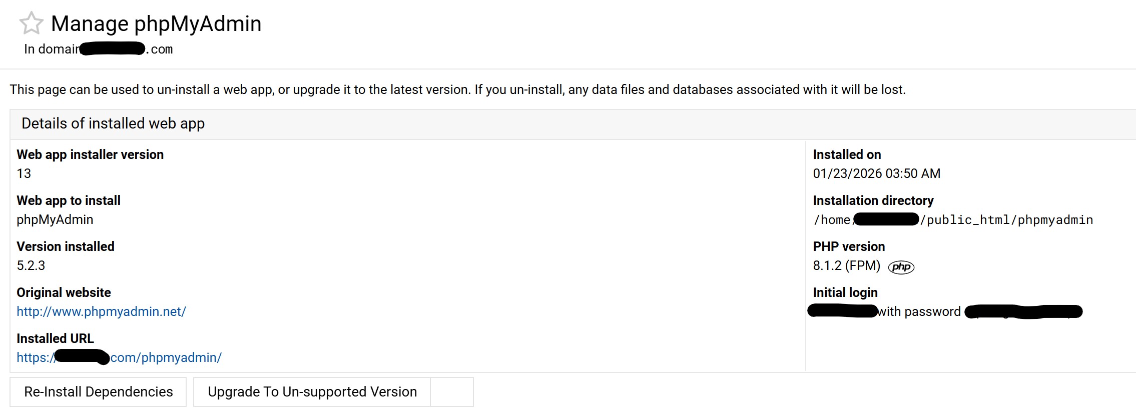

I did reinstall the web app for 2 domains, and yes now i see the folder in the public_html

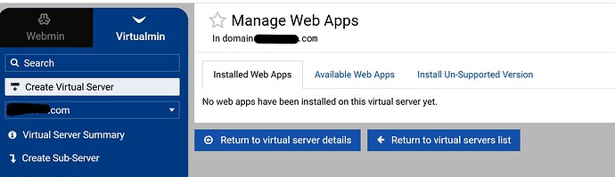

then delete the web app for phpmyadmin from all domains, but its still available ?
I woudl like to remove it completly, then re-install on a web-app basis for each domain, use a different name for the folder (as in the web app install), then add the IP restrictions.
How do i safely remove PHPMYADMIN ?
Let’s take the following situation, you have 10 domains hosted on your server. If you install phpMyAdmin in one of them, you will be surprised to find that on that domain, you can access the databases of the other domains (obviously with the username and related passwords). If I remember correctly a long time ago we discussed this in the old forum. But it is not a reason to worry, you can configure phpMyAdmin strictly to work on that domain, but Virtualmin does not do it, you do it manually. This could be an advantage, you can manage all databases with one installation to manage the rest of the domains (pretty close to cPanel).
I don’t understand what “safety remove” means, it is just an online database client. if you installed it through the Virtualmin interface, you have to delete it from there.
no, i only ever see the database for that domain within phpmyadmin.
I now do not have this as a ‘web app’ on any site, but still have access !! so need to know how to remove (from where as no domain has it as a web app !!) and start again.

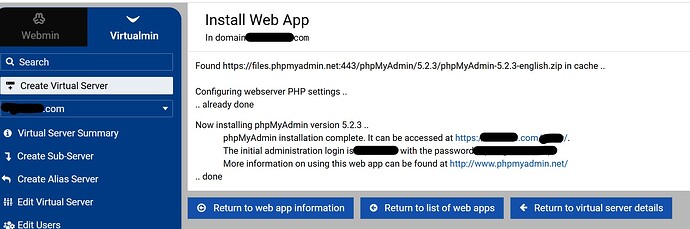

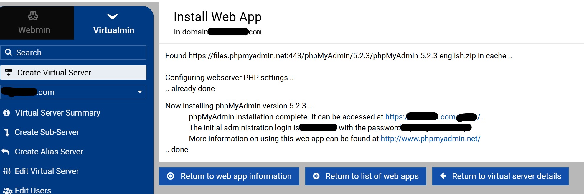

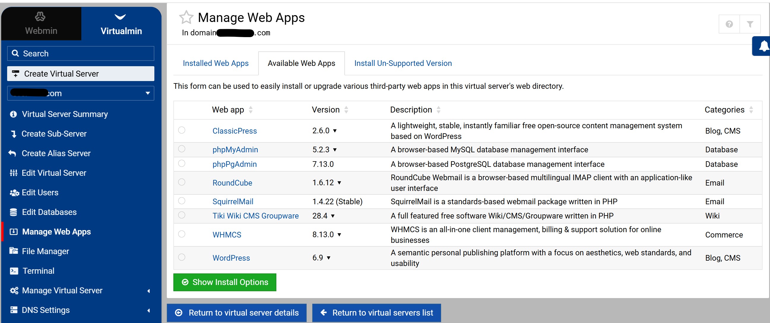

now no longer have it installed. so going to try now by adding the web app from 1 virtualmin domain, in a none obvious directory name
install worked, now only in 1 domain, and access from the new directory name, and access is with database for only that domain !

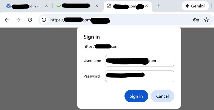

oK, it all works !!!
the issue must have been that phpmyadmin was installed as a moduel in the root OS, so after purging, and installing for one domain in virtualmin, naming the folder as unique name (not phpmyadmin!!!), then adding protected directory, all works
it works !!!

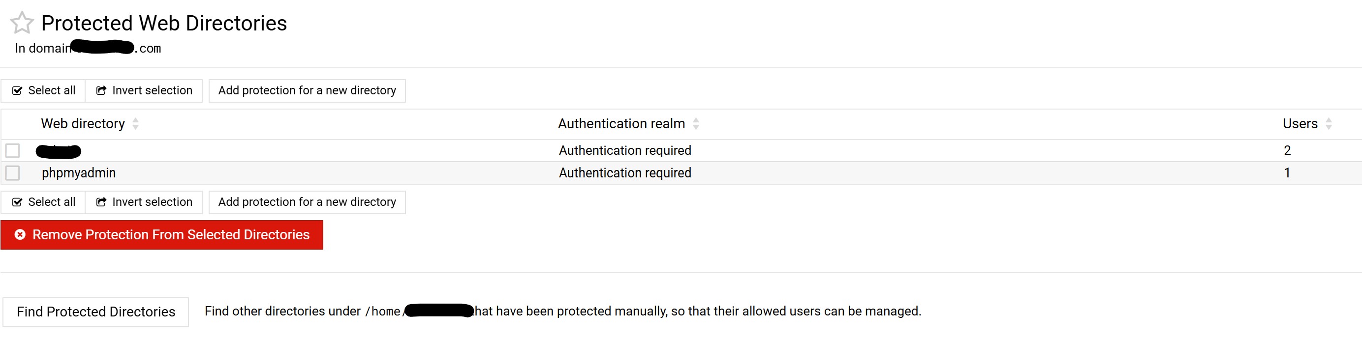

so do all agree, that the built in mechanism (protected directories) in Virtualmin works fine, and I do not need to add a htaccess file ?
No, we shouldn’t micromanage this, as it isn’t straightforward.
It’s better to install phpMyAdmin in a different non-standard directory and protect it with a basic auth password.
