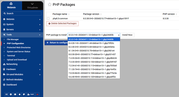

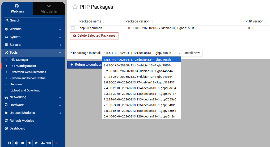

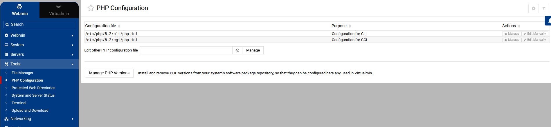

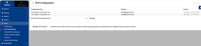

They can also be removed right in Virtualmin by navigating to:
Webmin > Tools > PHP Configuration and clicking on the Manage PHP Versions button.
Also, while there, it appears one can install any of the PHP packages from 5.6 through 8.5 at the time of this writing.
Especially important if you need a specific version to upgrade an older site to a later version.

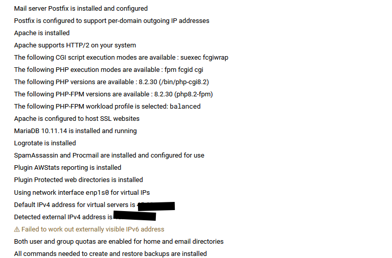

P.S. On vultr I just install Debian 12 and install virtualmin.
The recheck config shows only 8.2

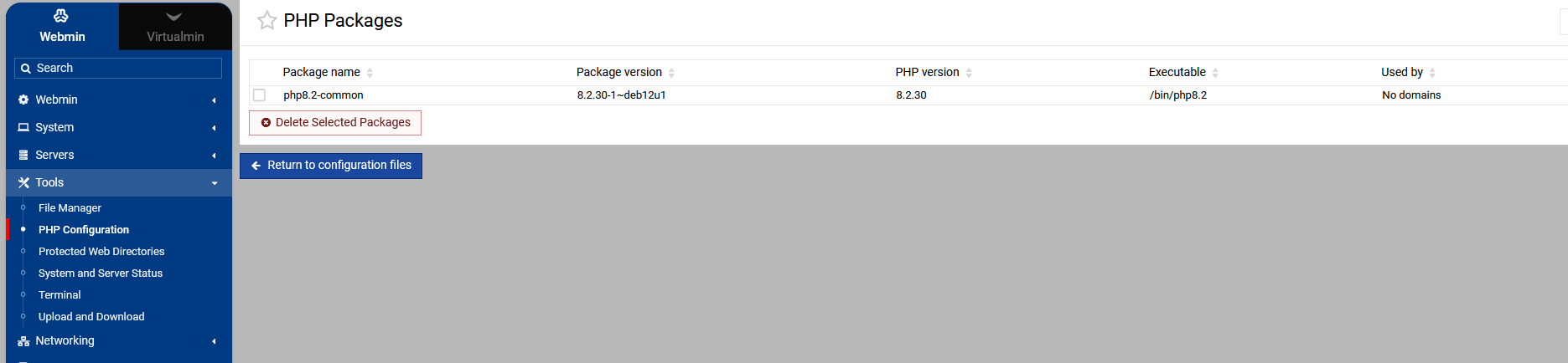

Ok, I see no 8.4 or 8.5 and no Sury/PHP repo

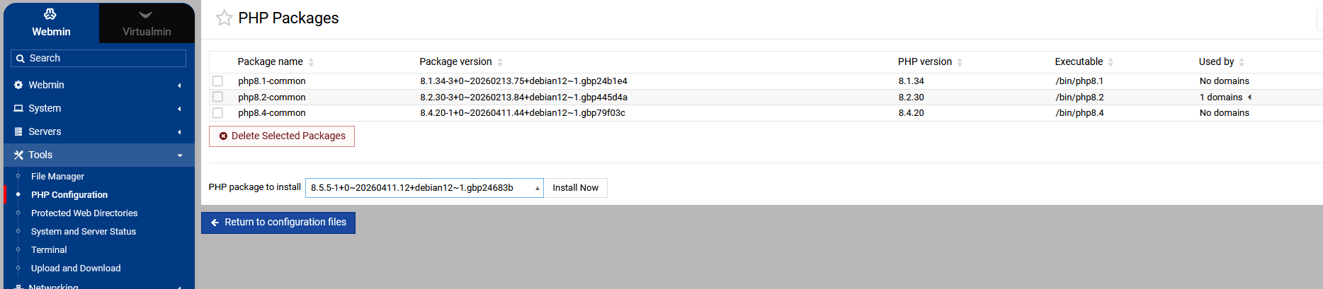

After install Sury repo from
I still only see 8.2 installed.

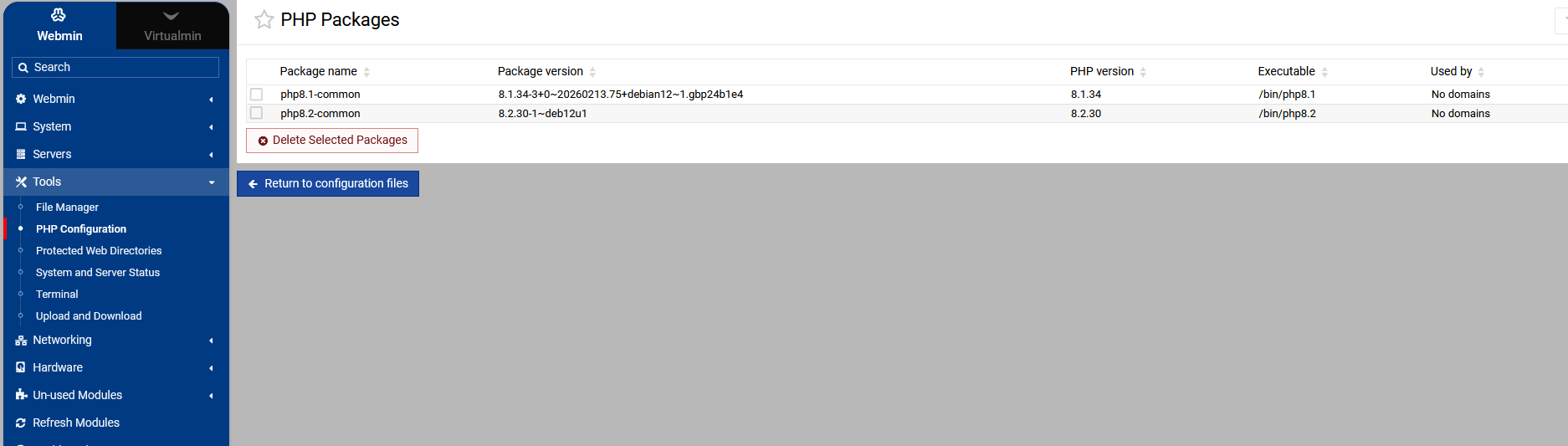

Weird, I don’t have any option to install new version in GUI only delete.
(I installed 8.1 from cli)
Noticed updates available and all seem for php.
After install I see 8.4 install without me requesting and I am able to install new versions.
as Joe mentions on occasions the package manager (apt for debian) handles the updates & webmin is just a wrapper for apt, in the debian case, apt which makes me conclude that the repro is pushing out newer versions for some reason. In my case the update added both php 8.4 & 8.5, it’s no great shakes as long as your aware that new versions of php are available to webmin/virtualmin and you may have to install missing php modules that your domains rely on, if you intend to use the automatically added versions of php.

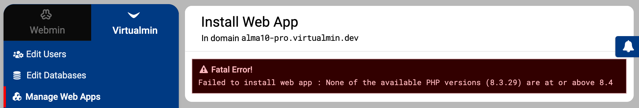

The web app installers in Virtualmin are designed to use an already installed PHP runtime and to auto-install missing PHP modules/extensions for that runtime. They do not provision a brand-new PHP runtime, such as PHP 8.4, as part of a script installation.
If no suitable installed PHP version is available for the installer to use, Virtualmin reports an error rather than installing a new PHP runtime, e.g.:
On Debian 12 and other Apache-based systems where suexec is available, Virtualmin can, in CGI/FCGId mode, assign a specific PHP version to the directory where a web app is installed. Yet, again, this works only with PHP versions that are already installed on the system.
