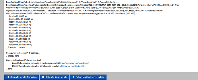

After proceeding with the upgrade I got an error message that no PHP version has been found.
I manually upgraded Roundcube.
Now I still have the sript installer tell me that there is an update. How can I delete the notification or how can I make virtualmin detect the completed update?

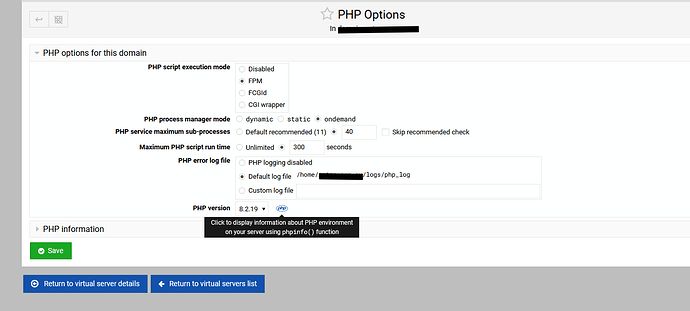

When originally installed I was probably on PHP8.0 or maybe 8.2, I am now on 8.3.
I did re-run the config check. But doenst seem to help.
I run other php apps that work fine, I think it is just not detecting somehting.
