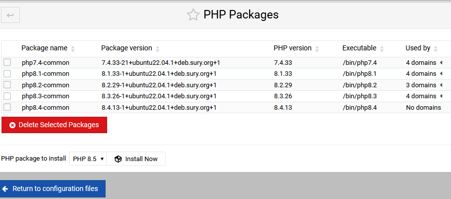

  • What happens if i delete a php version that is currently being used by domains?
  • will a notification come up telling me what will happen?
  • Maybe the next highest PHP version is selected and applied to those domains?
I only have my live server on at the minute and do not want to try it out on that system.

This package page ( I prefer the term php version) already identifies which domain is on which version.

Failed to delete PHP packages : Package for PHP version 8.3.26 cannot be uninstalled, as it is still being used by 4 domains

In the page where you can add and remove php versions, on each installed version it lists what domains are on that version, therefore a list of domains that need to be changed.
You either blocked the PHP version being removed (as si now) or you use the list to migrate to another version. This list will be generated by reading the php handler statements from the relevant place.
First, we won’t let you use the UI to uninstall PHP versions that some domains are currently using. Second, we shouldn’t micromanage things in any fancy way. Simplicity is a virtue.
can you make the checkbox greyed out, you should not even be allowed to select it. It makes it more logical for the end user.
The error message is useful for the CLI and server side validation.
Graying out a checkbox is worse than providing a clear and nice error message.

  • Why allow a user to make a mistake when you can prevent it in the first place.
  • The greyed out option shows immediately to the user that they cannot select it. So this allows notification to the user and prevention. a tooltip on hover explaining why is also very useful.
  • If you remove the checkbox when the option is not available is problematic as it will confuse the user.
I appreciate a lot of your error checking is done server-side, but there is nothing wrong with client-side, or both.
