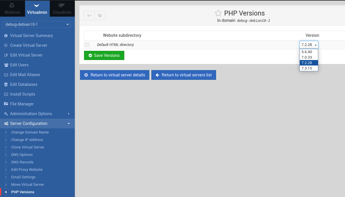

Those are controlled by a handler in Apache configuration. Virtualmin has a page, called PHP Versions, located at Server Configuration, where you can choose which PHP to use with current virtual-server.
Note: It only works if you have set FPM or (F)CGId as execution mode in Website Options.

You should have it set as current version in PHP Versions page. Additionally, I will point out again, that you would need to patch mentioned above file, to make PHP 7.4 detectable by Virtualmin with version 6.08 and below. Upcoming 6.09 will have this working out of the box.

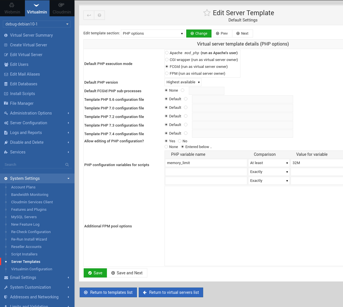

You should also check Server Templates, as default PHP version for new domains is defined there. However, by default it’s set to Highest Available.

It’s under System Settings/Server Templates:
Now you have made me look like an idiot! I have no idea how I missed it. Thanks. What about the patch? Do you know when 6.09 is due for release?
It was set to highest so have adjusted it to 7.2.8 and am now going to retry.
