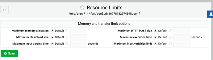

in /etc/php/7.4/fpm/pool.d
There are two files one is www.conf and the other one is 16778132974398.conf
www.conf
This is what it looks like
16778132974398.conf
Screen Shot 2023-06-13 at 7.47.48 PM
Really confused with these two files I’m not sure what it does.
