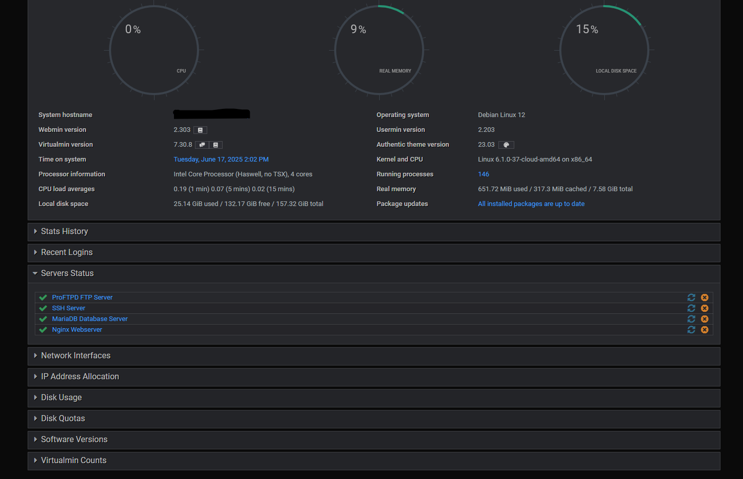

Hi, virtualmin server dashboard has all services monitored, but didn’t have PHP-FPM monitor.
We have son vrtualhost configurated by Nginx with PHP-FPM 8.2.

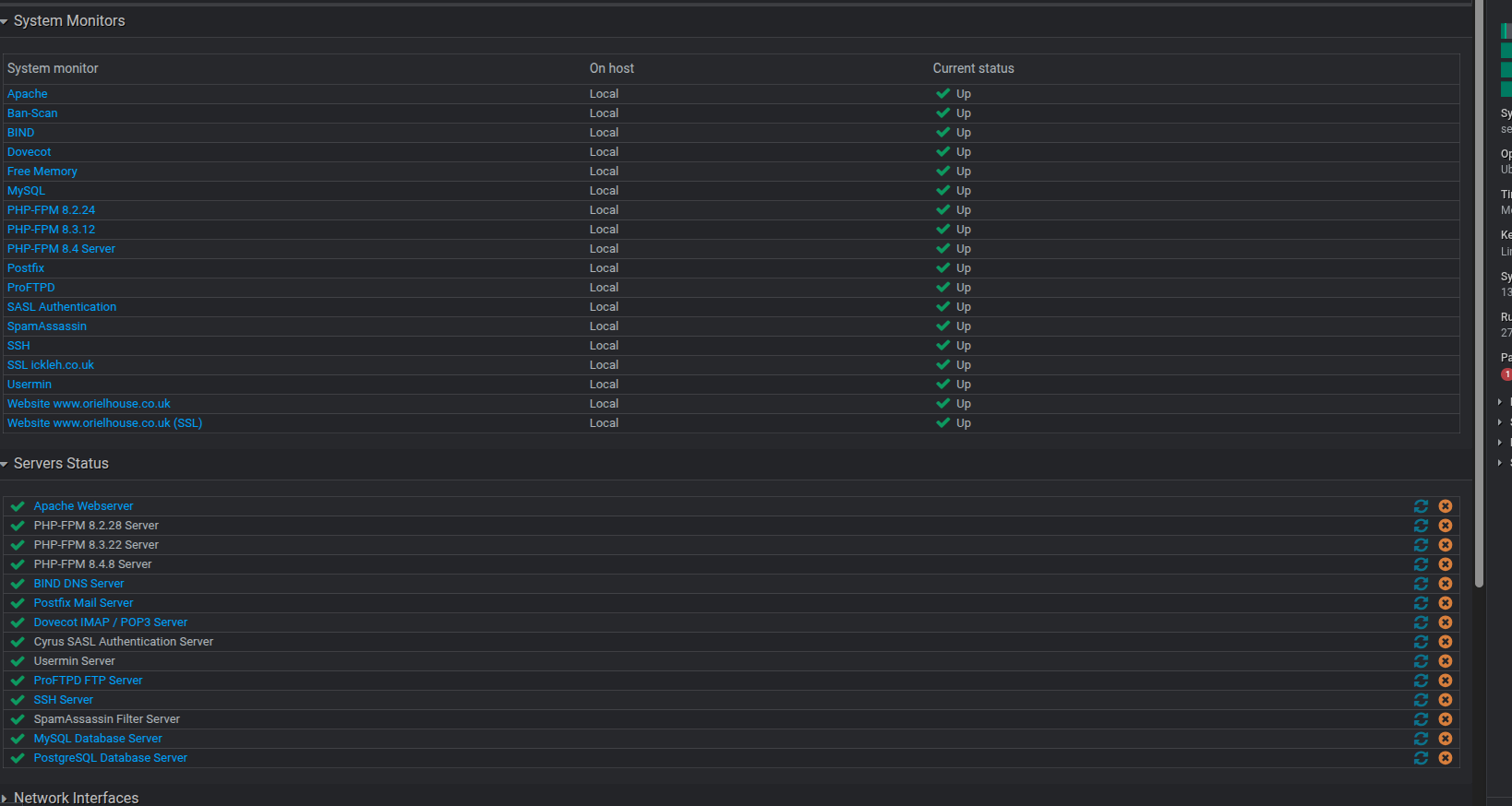

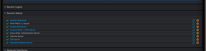

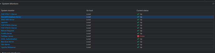

are you talking about Server Status or System Monitors as virtualmin includes Server Status and webmin doesn’t ?
This is virtualmin Server Status
and this is system monitors
and it’s possible to have both

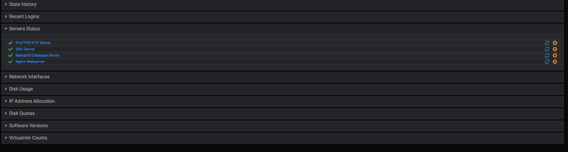

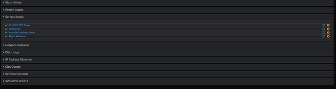

php-fpm does not appear in Servers Status.
I do not find Sytem monitor in the dashboard
you need to add that but now I see what you are talking about. perhaps @Ilia could shed some light on this ?
PHP-FPM status monitors should already appear on the dashboard if you have the latest Virtualmin 7.30.8 installed. If they don’t show up, try clicking the force-refresh system information button at the top right of the dashboard.
