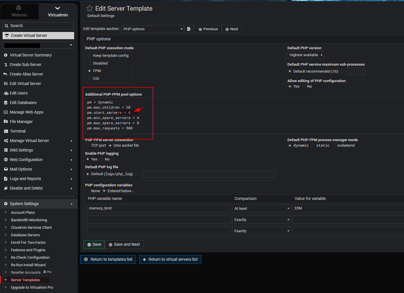

But initially -before changing the PHP version- start servers had value 4 and this is also set in my Virutalmin configuration > Server Templates configuration.

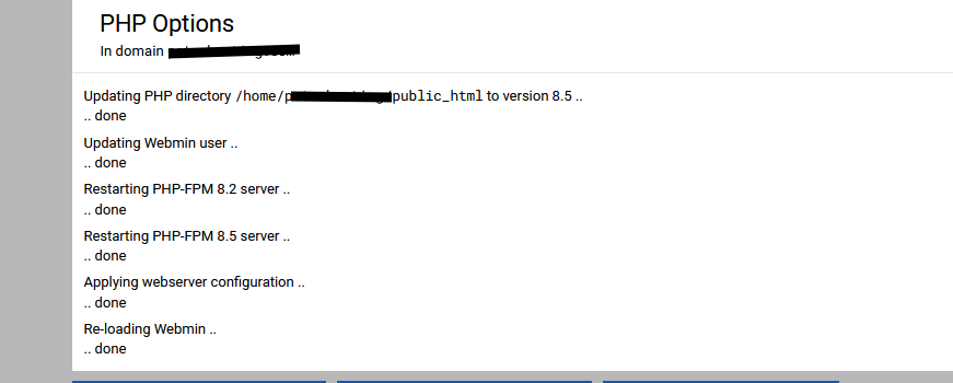

I just check on a dev machine, this is what I have as default
Have you made changes in the template?
I installed 8.5 (per doc on VM website)
change to it in options of domain and all server restarted fine

in my default server template it’s also set to 4. This is also assigned to my domains.

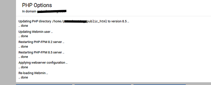

hi Ilia
many thanks this seems to work (just tested on my development host, will do my production system tomorrow).

I’ve applied the patch to my production-server now as well and that too is working. Thanks a lot for your efforts & support!
