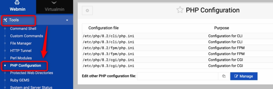

But the location according to the webmin manual above the PHP configuration settings should be found in “Tools”:
https://i.postimg.cc/X7144dJB/2024-08-27-04h17-31.jpg

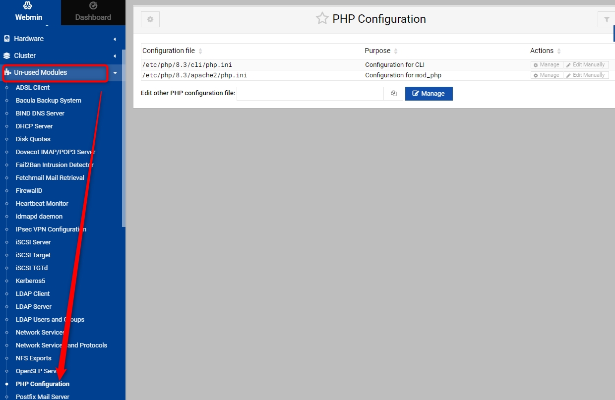

But in our just installed version of Webmin I cannot find it at all there. Instead it resides in “Un-used modules”:
https://i.postimg.cc/0PnNVJ8s/2024-08-27-04h20-51.jpg
Now does that mean that?:
  1. It isn’t active and really used by Webmin?
  2. If that is the case (See #1), how do we “configure” install PHP so it is active in Webmin?
  3. Is there something we missed that generated this result?
  4. It doesn’t seem like all PHP versions is installed?

I’m pretty sure you should be using Virtualmin, and not Webmin alone. If you’re trying to manage websites in Webmin, I strongly recommend you start with a freshly installed supported OS and follow the Virtualmin installation docs.
If you really insist on doing this in Webmin alone (you almost certainly should not!), you’re still making mistakes here.
You should not install the php package. You should install the specific execution mode you need (php-fpm recommended, as well as the php-cli package, and whatever modules you need). Installing php package all by itself will install mod_php, which should never be used today. It sucks that that’s how the package is named and how the dependencies work out, but we can’t control what the OS vendors do. So, uninstall mod_php. You should never use it. Then install the stuff you intend to use.
Then, click “Refresh modules”. Assuming you have everything you need to run PHP applications, you’ll probably see PHP Configuration show up in Tools.
But, really, unless I’m guessing wildly wrong about what you’re trying to do, Virtualmin is going to be the nicest experience for you, by far. To be clear: Webmin by itself is not for managing websites. Virtualmin is.

PHP Configuration will appear in Tools, if everything needed to run PHP is installed. (It looks for php or php-cgi command. I’m pretty sure if you follow the instructions I gave above, it should work.)
