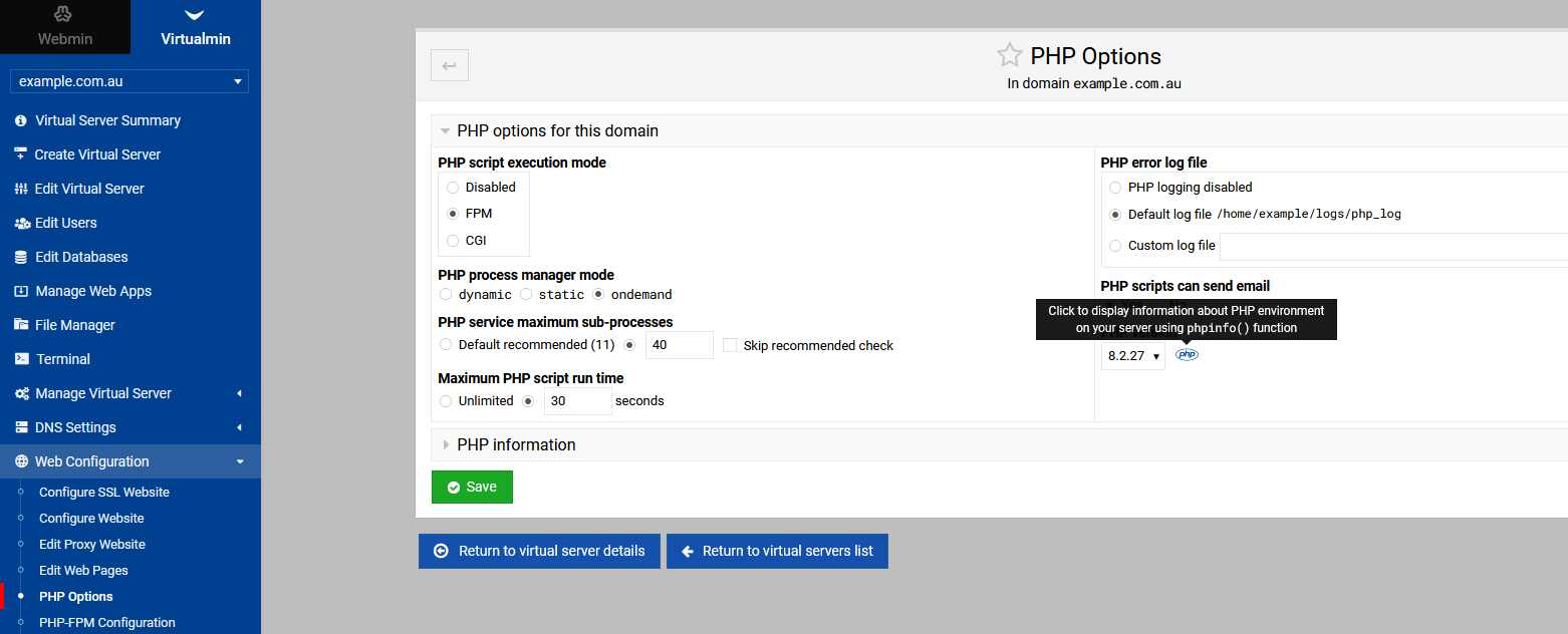

No need, phpinfo() is in the GUI.
WOW! thank you for sharing this. it works perfectly.
