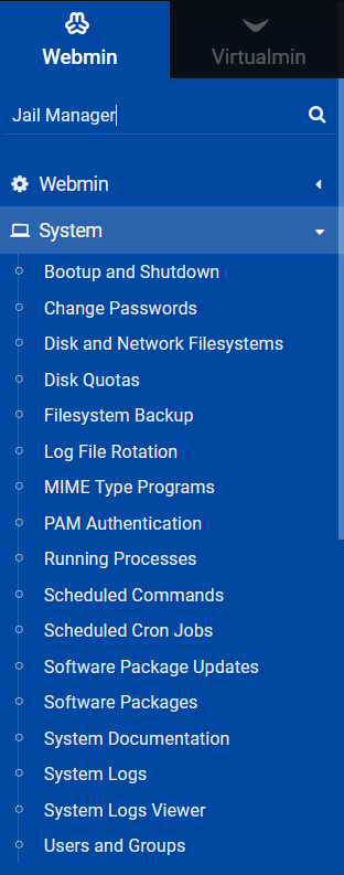

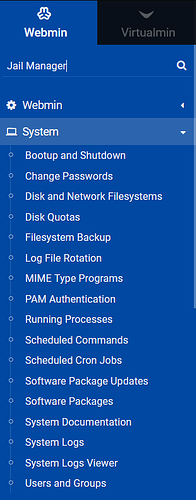

It’s in Webmin->System->Jailkit Jail Manager, in case you hadn’t found it yet.
The picture attached shows all of system, also searched for jail manager and, I also looked in un-used modules as well.
Thank you
Huh. webmin-jailkit is somehow no installed, I guess.
You can install it with apt install webmin-jailkit.
