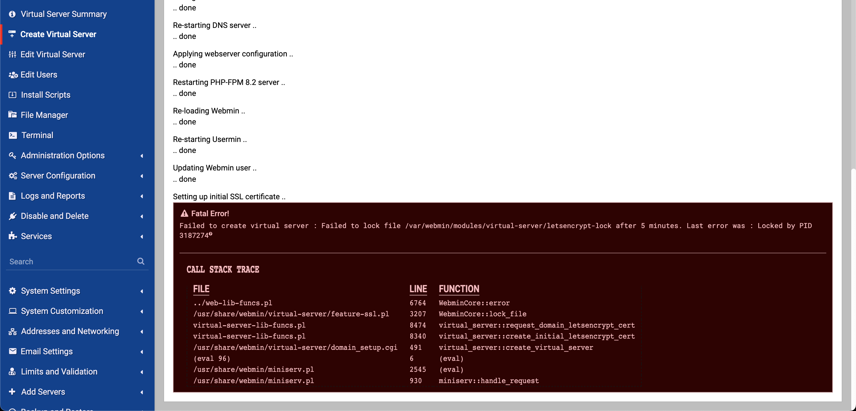

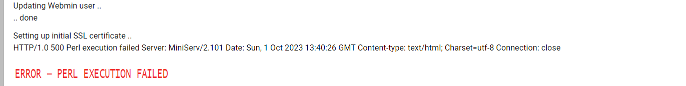

Just attempted to add a new VS and something went wrong!
which inevitably results in
and I guess a whole bundle of other problems.

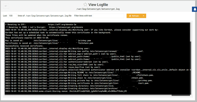

Is there an actual error printed under ERROR - PERL EXECUTION FAILED message?
This error seems completely unrelated.

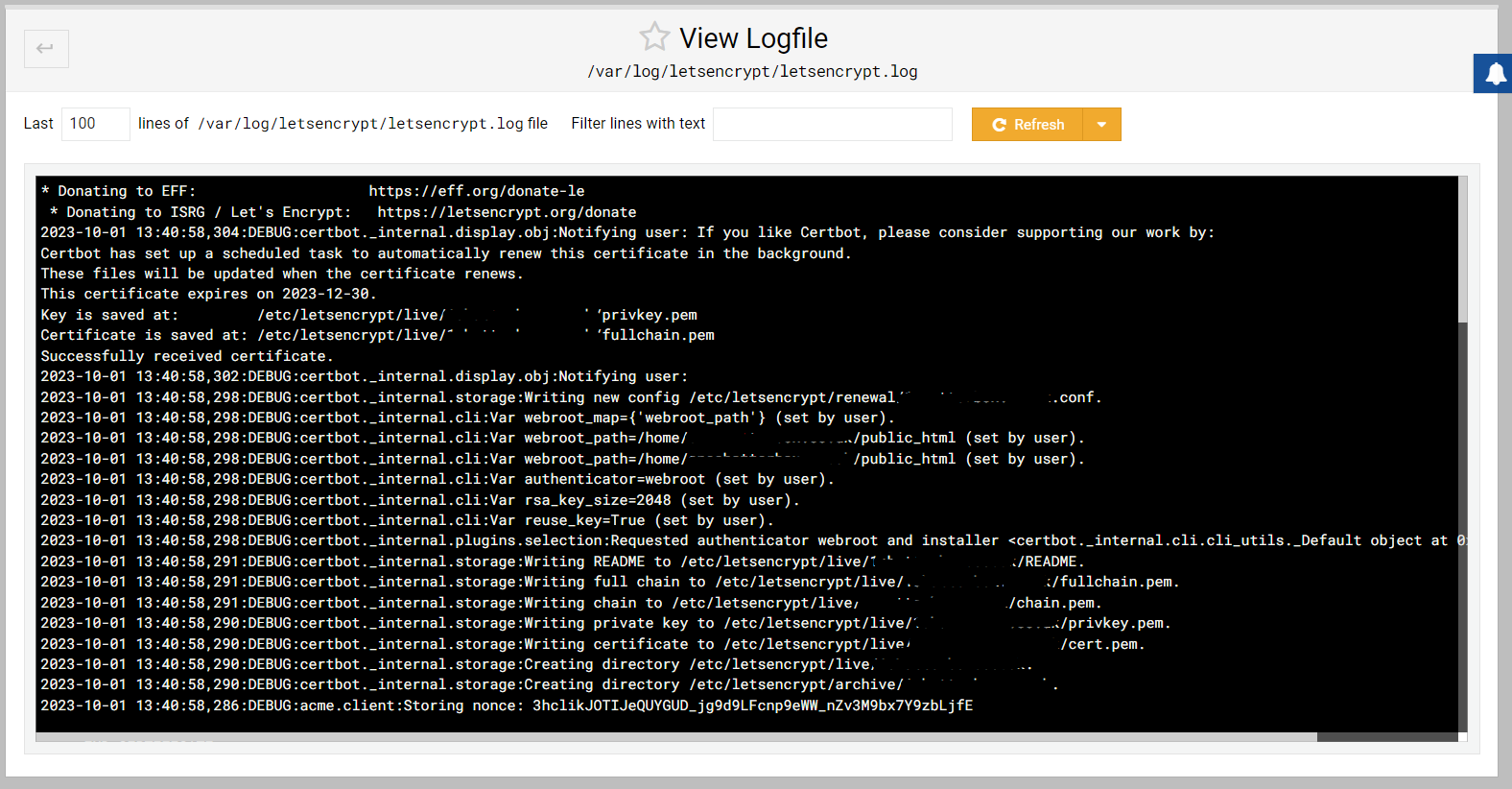

Also, if you look at /var/log/letsencrypt/letsencrypt.log – do you have anything logged there?

 [01/Oct/2023:00:02:12 +0300] Failed to lock file /etc/webmin/virtual-server/domains/16568431051281542 after 5 minutes. Last error was : Locked by PID 30112>
 Error
 Failed to lock file /etc/webmin/virtual-server/domains/16568431051281542 after 5 minutes. Last error was : Locked by PID 3011229 ../web-lib-funcs.pl (line >
However, this is expected (for this particular background job), as there was another process running (upon domain creation time). To be clear, the log with file lock error is background job.

If mentioned background process is running, the SSL request upon a new domain creation time also fails, even though it shouldn’t as it’s a separate domain, e.g.:
What can be the problem? Is this the recent change related to extra locking? Can you please have a closer look?
I think this may be due to the deadlock I found recently when doing DNS-based validation. The fix is here : Fix deadlock when doing DNS-based LE renewals https://forum.virtualmi… · virtualmin/virtualmin-gpl@8596595 · GitHub

I was focusing on the “Perl execution failed” rather than the “Error”

That log above suggested that the web based challenge worked (though perhaps just not applied) I have just tried to load the page in the browser (Chrome) again and am getting
403 Forbidden nginx/1.18.0 (Ubuntu)
