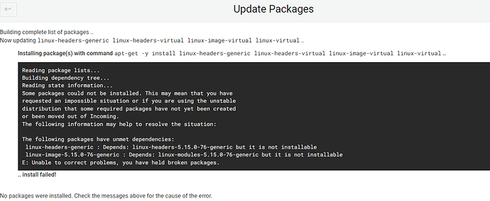

As each box provide comes into life (they are located in different countries / time zones - so get package update checks at different times) I am getting “package updates are available”

But running the update gives the following error
I can’t believe a package has been released without a dependency!
Should I just ignore this and wait another 24 hrs?

I’d say yes. This could be related to their new ‘staging’ policy.

The following packages have been kept back:
linux-generic linux-headers-generic linux-image-generic
0 upgraded, 0 newly installed, 0 to remove and 3 not upgraded.
The simple command-line upgrade does not show the “problem”, only 3 packages that are kept back. This behavior has been discussed earlier at the forum.
Yeah. They were working on a way to get the GUI to just show the ‘recommended’ instead of the ‘available’ I think. Personally I think it is kinda broken behavior on Ubuntu’s part, but, that’s only my opinion. Release it or don’t.

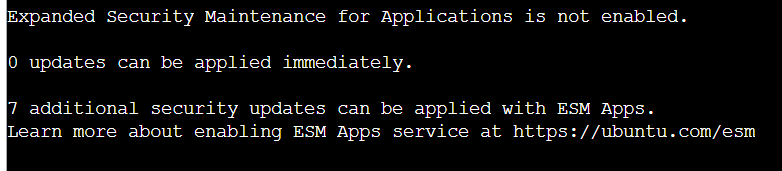

Not as far as I can tell but have noticed
Which sort of implies only available with “Pro” Ubuntu.

Not sure why this message even shows up on the latest LTS version though. Did you follow the url? 10 year extended maintenance?

I think the error is now fixed, if you search again it should find 9 packages for update and run successfully.

You are correct. All boxes after 48 hours now seem to have updated without errors - the powers that be must have noticed.
Yes, but it seemed that $$$ was being sought - so forget that. Only got me thinking - why am I a supporter of Ubuntu?
