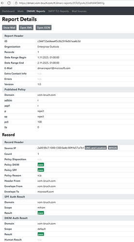

I know you have dmarc configured, why don’t you make the dmarc reporting enabled so you can see what is happening.
should be fine.
Is this report thing something you have done yourself or is it something I can setup on my server?
You can get it here:
cry-inc/dmarc-report-viewer: Lightweight Standalone DMARC and SMTP TLS Report Viewer with IMAP Client
I use it with docker. :+1:
If you don’t want to host yourself, set up an account with https://dmarcian.com/ and let them do the reporting and visualisation.

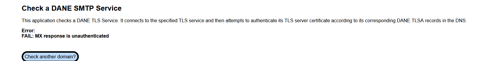

In my experience, the culprit is usually DANE. DANE breaks every time your mail server’s SSL certs are re-issued, and needs to be manually re-compiled. You can check your DANE validity here: Check a DANE SMTP Service . This site is also pretty good with various mail server checks: https://en.internet.nl/ . Don’t bother with MX Toolbox or the Newsletter checks; they’re hopelessly out of date.

Is DANE a part of Virtualmin, I don’t think I’ve heard mentioned here before.
I get this error on my server, so I guess not
P.S. Ok its got to do with DNSSEC, I don’t use :slight_smile:
