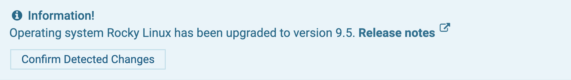

Blue box says this:
Information!
Operating system Rocky Linux has been upgraded to version 9.5. Release notes
Button: [Update Detected Operating System]
What exactly does this mean? What will clicking that button do?

The message means exactly what it says: “Operating system Rocky Linux has been upgraded to version 9.5.”
I don’t know how it could possibly be made more clear. And, it clearly says it is “information”. It’s not a warning, it’s not an error. It’s just telling you that the version of your OS has changed. Clicking the button will update the OS that Webmin has detected, so it’ll stop telling you the OS has changed. It does not upgrade the OS or run dnf, because that has already happened.
When you update all packages regularly using your system package manager (dnf in the case of any EL, like Rocky), it will occasionally upgrade to a new minor release. That’s normal, expected, and good. Webmin is telling you you’re on a new minor version. That’s it.

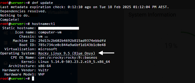

If you use sudo dnf update (no y switch, that will stop a yes to go ahead with the update), what does it say?
and maybe hostnamectl to see the version of your OS

Yes, agreed. And I believe that this is exactly what needs to change—the button’s text clearly requires improvement. In the next Webmin release, it will be displayed as:
