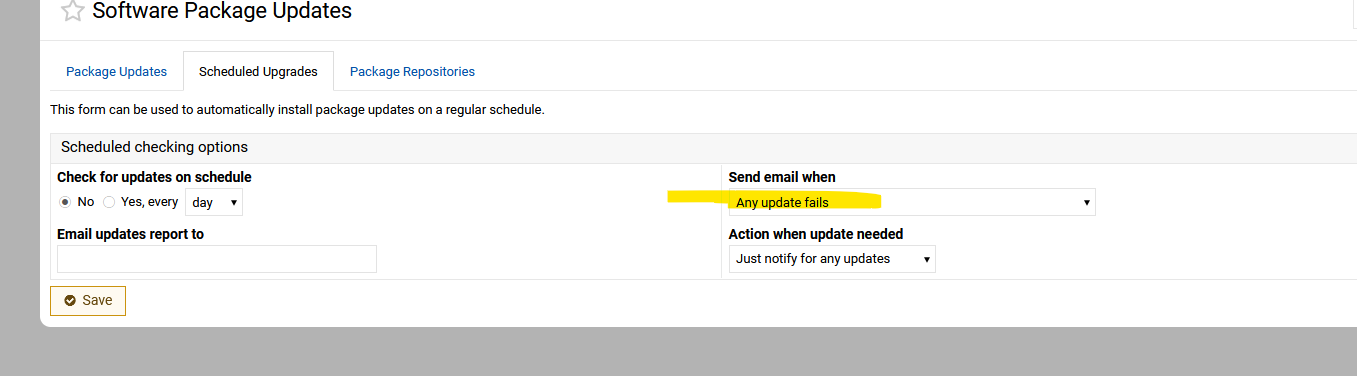

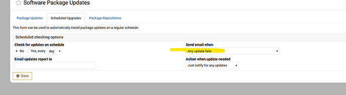

You could setup a schedule update and get a email report when failed
