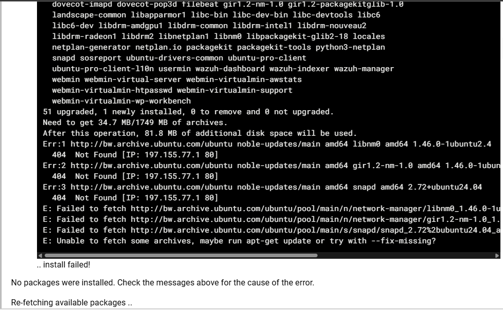

No update regardin sudo upgrade
System hostname server.workliflysolutions.co.bw (10.1.4.252) Operating system Ubuntu Linux 24.04.3
Webmin version 2.520 Usermin version 2.420
Virtualmin version 7.50.0 Professional Authentic theme version 25.20
Firewall version ConfigServer Security & Firewall 14.24 Time on system Tuesday, February 3, 2026 2:03 PM
Kernel and CPU Linux 6.8.0-90-generic on x86_64 Processor information Intel(R) Core™ i3-6100 CPU @ 3.70GHz, 4 cores
CPU temperatures Core 1: 31 °C
nameserver 8.8.8.8
what is issues?

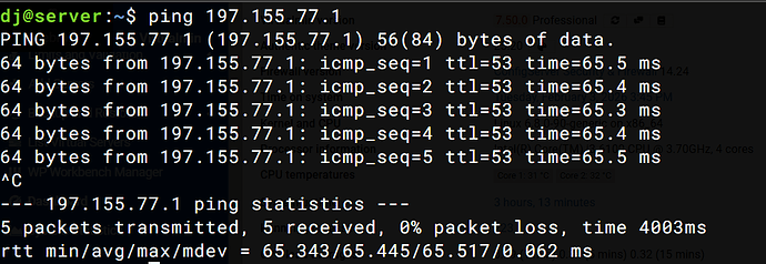

Have you tried again? That seems to be a mirror in Kenya.
mit@~:ping 197.155.77.1
PING 197.155.77.1 (197.155.77.1) 56(84) bytes of data.
64 bytes from 197.155.77.1: icmp_seq=1 ttl=47 time=228 ms
64 bytes from 197.155.77.1: icmp_seq=2 ttl=47 time=226 ms
64 bytes from 197.155.77.1: icmp_seq=3 ttl=47 time=226 ms
64 bytes from 197.155.77.1: icmp_seq=4 ttl=47 time=225 ms
64 bytes from 197.155.77.1: icmp_seq=5 ttl=47 time=226 ms
64 bytes from 197.155.77.1: icmp_seq=6 ttl=47 time=226 ms
64 bytes from 197.155.77.1: icmp_seq=7 ttl=47 time=225 ms
^C
--- 197.155.77.1 ping statistics ---
7 packets transmitted, 7 received, 0% packet loss, time 6007ms
rtt min/avg/max/mdev = 225.099/225.955/227.912/0.849 ms
inetnum:        197.155.77.0 - 197.155.77.255
netname:        Mirror_Servers
descr:          Mirror servers
country:        KE
admin-c:        AA110-AFRINIC
tech-c:         AA110-AFRINIC
status:         ASSIGNED PA
mnt-by:         LIQUID-TOL-MNT
source:         AFRINIC # Filtered
parent:         197.155.64.0 - 197.155.95.255
Yes i use Liquid telecoms link as well.
This isn’t a Virtualmin or Webmin issue. It’s a problem with the OS repo mirror you’re querying.
You can try sudo apt clean; sudo apt update to see if starting fresh allows it to work. If not, you may need specify a known-good mirror in your apt configuration.
