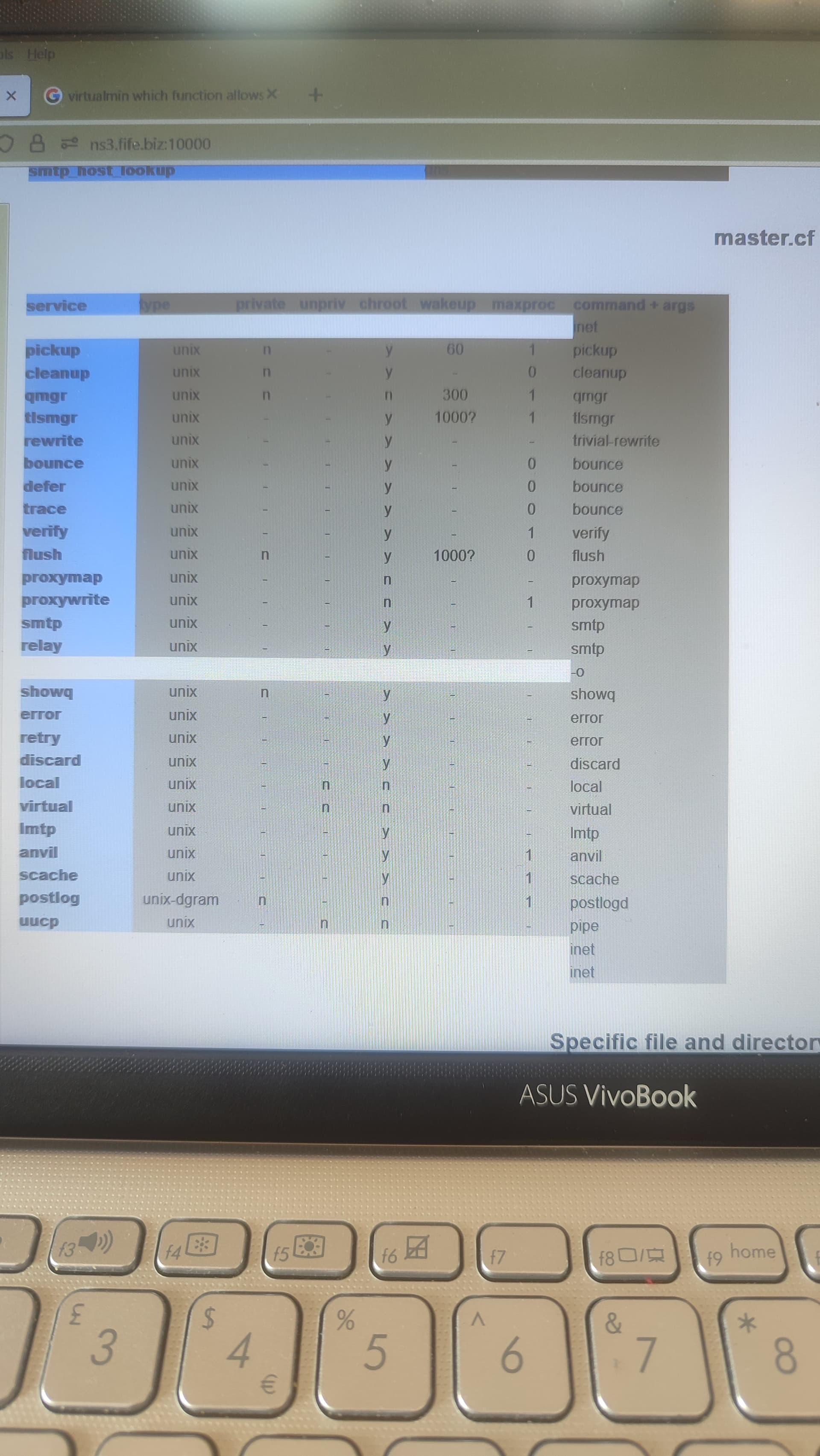

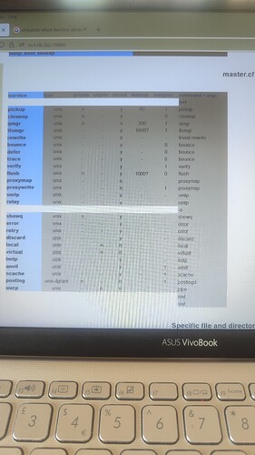

I’ve a feeling there may be a clue in here:
master.cf

Virtualmin install scripts installed every to work out of the box, please don’t go around and play with postfix configuration.

To be clear, you should not try to enable SSL on the SMTP port if you want to run a general-purpose mail server. I don’t know where anyone got the idea you should. You can allow STARTTLS, but lack of SSL is not the problem you should be trying to solve here.
To be clear: if you think you need to change anything in master.cf for basic mail functionality, you’re barking up the wrong tree. Basic mail functionality all works out of the box on a default installation of Virtualmin. There may be things you want to change for additional spam or auth or whatever features, but “my server can’t receive mail” is not a thing you need changes for.

I only mention the master.cf file as someone may spot a setting that is wrong. :o)

have a confession
an error by me, seems to have been the SMTP Greeting banner, somehow it was set to $hostname instead of $myhostname ESMTP $mail_name
mxtoolbox shows as good now.
however, the emails are being placed in the queue but not sending.
so it’s a different problem. apologies for the confusion.
