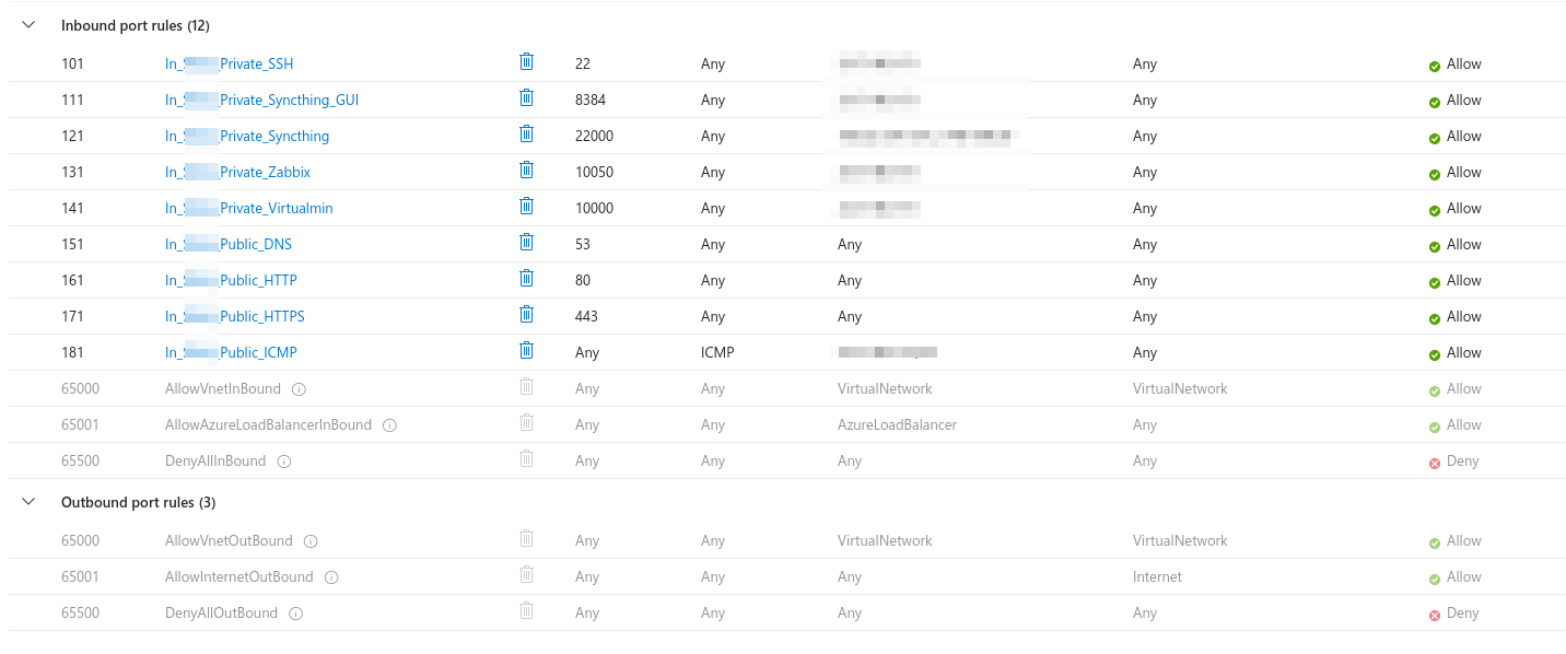

NSG Rules:

UFW was disabled by the apt update, defaulting to no network. Enabling it in the serial console was the fix.
