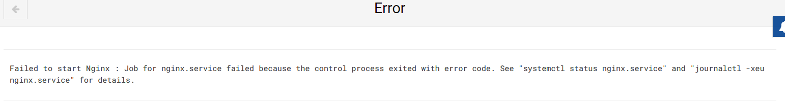

But now that old bug (the one where nginx fails to auto restart after a reboot) has reappeared!
trouble is worse now as the nginx webserver totally refuses to start:
indicating something is wrong with virtualmin-nginx/start.cgi (line 12)

I had the same. Seems it at somepoint and for some reason decided to install Apache.
Go to - System - Bootup and Shutdown and disable and stop Apache and Nginx should start. as you cant have 2 services on port 80.

Start-Date: 2024-05-14 03:38:33
Commandline: apt-get -y install virtualmin-lemp-stack
Install: libaprutil1-dbd-sqlite3:amd64 (1.6.1-5ubuntu4.22.04.2, automatic), apache2-data:amd64 (2.4.52-1ubuntu4.9, automatic), apache2-bin:amd64 (2.4.52-1ubuntu4.9, automatic), php-json:amd64 (2:8.1+92ubuntu1, automatic), apache2:amd64 (2.4.52-1ubuntu4.9, automatic), libaprutil1-ldap:amd64 (1.6.1-5ubuntu4.22.04.2, automatic)
Upgrade: virtualmin-lemp-stack:amd64 (7.0.4-1, 7.0.5-1)
End-Date: 2024-05-14 03:38:44

Thanks that solved it. Once I also “disabled on boot” and then rebooted.
