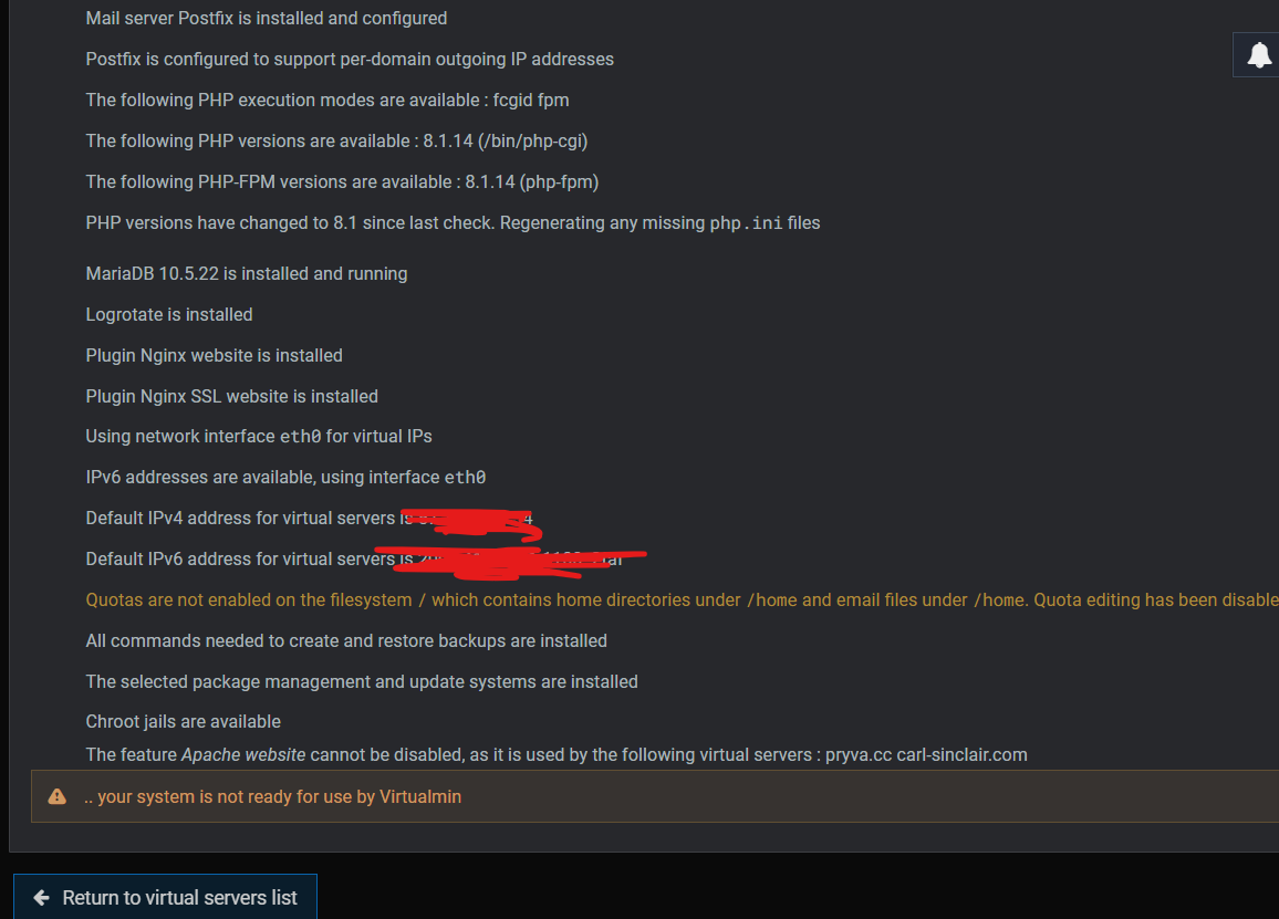

Why does it say my system isn’t ready for Virtualmin even though all of the tests are passed and it says everything is configured successfully?

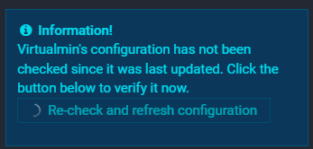

It’s currently spinning but when it stops the message won’t go away. It’ll keep prompting me to check my configuration.

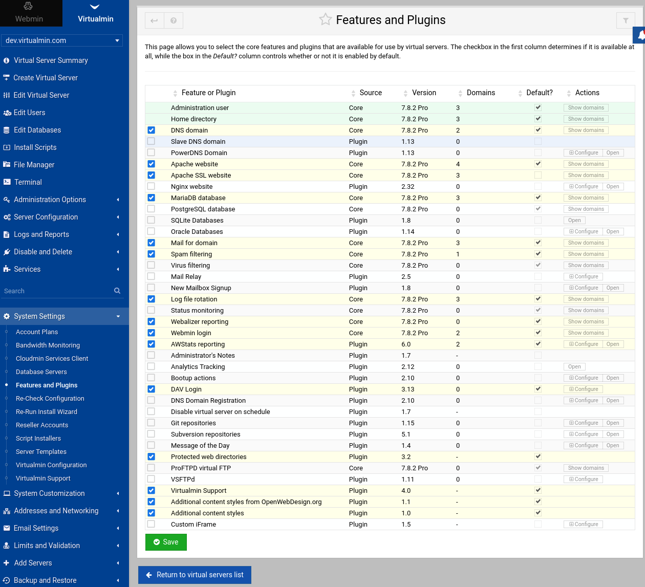

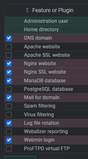

This. It seems like you tried to disable the Apache Website feature in Features and Plugins. You can’t do that, given the circumstances (and you don’t want to do that…if you want to use nginx exclusively, you should start over with an nginx --bundle LEMP install…you can, as I mentioned, do whatever custom thing with nginx you want, in addition to Apache, but if you’re trying to turn off Apache entirely, just don’t have it!).
Note, you cannot have both nginx website and Apache website enabled in Features and Plugins (and you’ve found some of my explanation for why). Virtualmin does not, and will not in the future, manage both on the same system. You can use both, but Virtualmin is only ever going to know about and manage one of them directly. (You could add custom post scripts or extra files in your skel or do stuff in Server Templates to automate it, if you wanted to, but we aren’t going to build that, as it is almost always a mistake that we want nothing to do with.)
I did attempt to disable Apache at one point, yes, but that was only temporary. I didn’t know I’d have to live with that decision for the rest of my life.
I’ll take your advice and reinstall to undo that mistake. But since Apache support is better (according to Stefan), shouldn’t that be the option I go with?

I’m just saying enable Apache Website in Features and Plugins and save it and re-check config.
Whoa, it’s disabled? I have not stopped managing Apache through Webmin/Virtualmin.
Webmin is independent of Virtualmin (but Virtualmin is not independent of Webmin). Disabling Apache in Virtualmin Features and Plugins does nothing to the Webmin Apache module.
