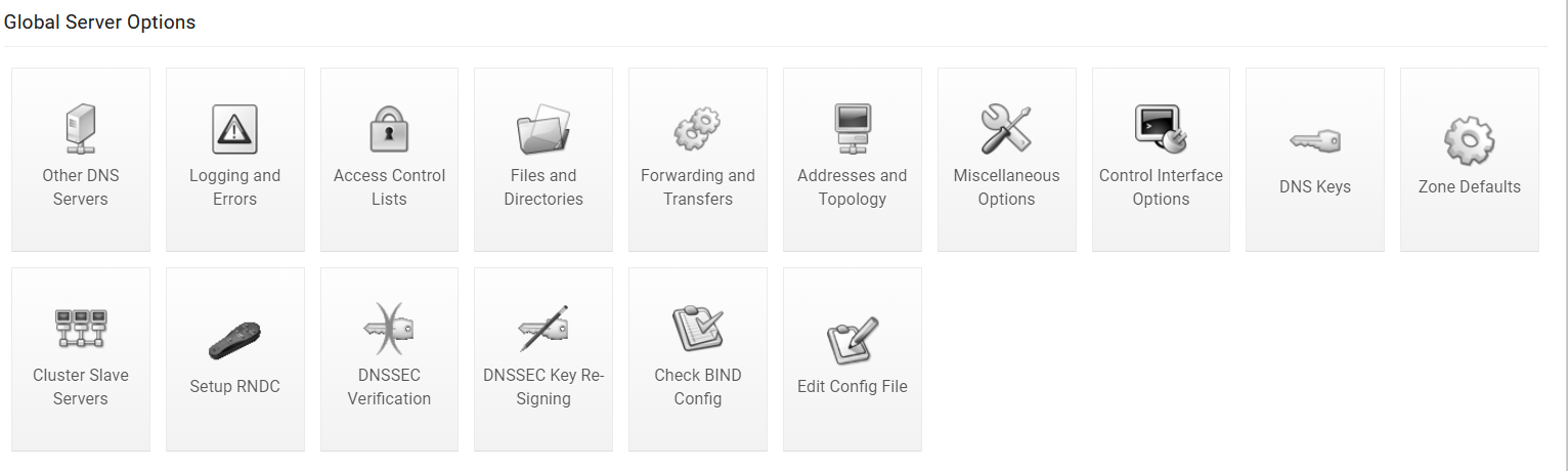

have you checked here
Yes, different values? but they seem correct (unchanged)

Because those domains don’t have DNSSEC enabled. It can be setup using Servers ⇾ BIND DNS Server: domain — Setup DNSSEC Key page.
Confused … `
gives me:
No Setup DNSSEC Key
and a list of existing servers (all are included) all of type “Master”
As I have never been here before, why is it that 2 VS were setup (a & c) but the others weren’t? all these VS were created new in Virtualmin in the normal way. (over some time/versions)
