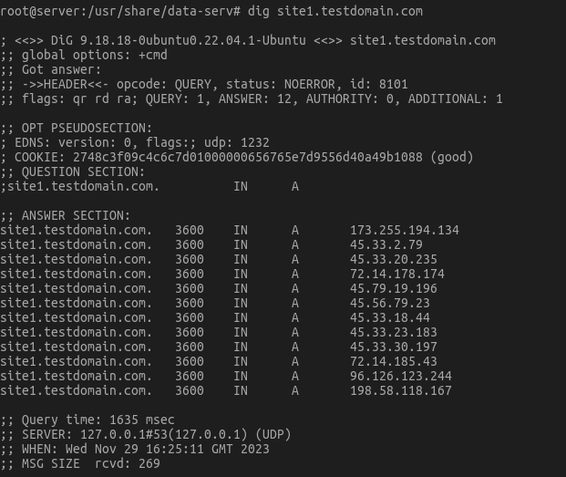

get real letsencrypt will need the domain to resolve to an IP address to work using the mechanisms that
does not appear to listed here, and if you dig site1.testdomain.com
you get
notice the missing 217.76.60.120
