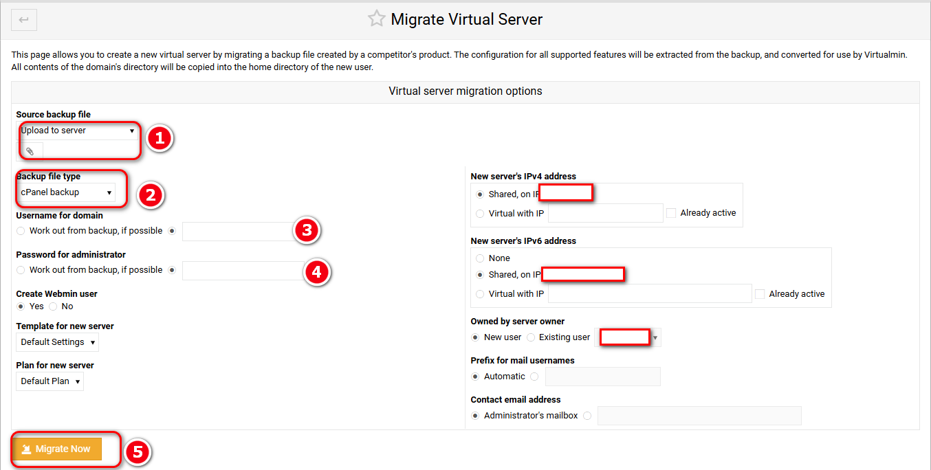

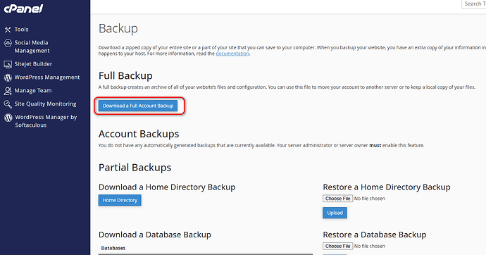

  1. Go to cPanel of one of the 5 accounts and create a full backup
  2. After backup done, I go to file manager and download the backup file to my local computer
  3. Then I login to Virtualmin and use its Migrate Virtual Server feature with Backup file type: cPanel backup
  4. After migrating finished, the site working properly but other sites/accounts on my reseller account, which have not been migrated to Virtualmin, are not accessible (return 404 not found)
I think this issue happened due to change in DNS zone (because the Virtualmin server IP is different from the reseller account)
I have to restore the Virtualmin server to previous state from backup, so that all the sites working
again
Please help me to have a better way to achieve this. Thank you so much!
