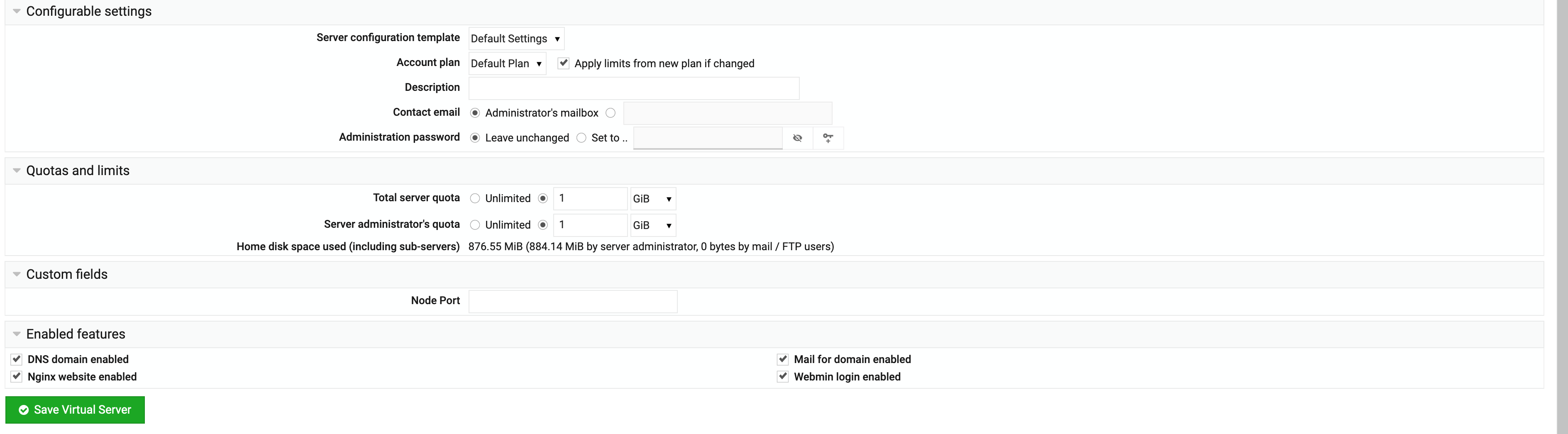

So what I need is the ability to set the port number for proxy_pass. If I create a ‘Custom Field’ like this:
This creates an input box when editing a virtual server:
I’ve tried to add this field using $FIELD_nodeport in the plugin conf for Nginx, as follows:
However when I create a new virtual server, I get the following error:
Applying Nginx configuration ..
.. configuration is invalid : nginx: [emerg] unknown "field_nodeport" variable nginx: configuration file /etc/nginx/nginx.conf test failed
So my question is: how do I get the value of nodeport into the nginx server block (as it looks like I can’t use the additional nginx route, unless I’m doing it wrong!)?
