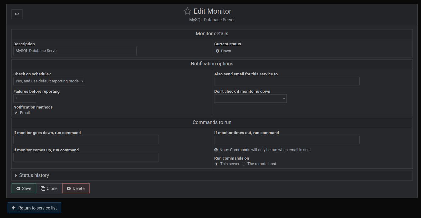

Hi there, I have a problem that MariaDB is suddenly crashing all the time, and the logs don’t reveal why…
I’ve had LAMP servers for a decade where this never happened, so I’m not sure why it’s a) crashing and b) not being restarted by some Cron job of Virtualmin.
This is the default setting, should I change anything?
MariaDB error message
The full MariaDB error message was : DBI connect failed : Can’t connect to local MySQL server through socket ‘/var/run/mysqld/mysqld.sock’ (111) ?
Once I click on “Start Maria DB”, it’s all fine again.
