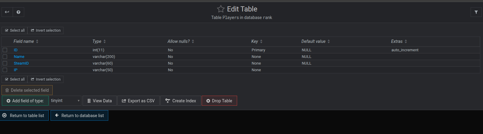

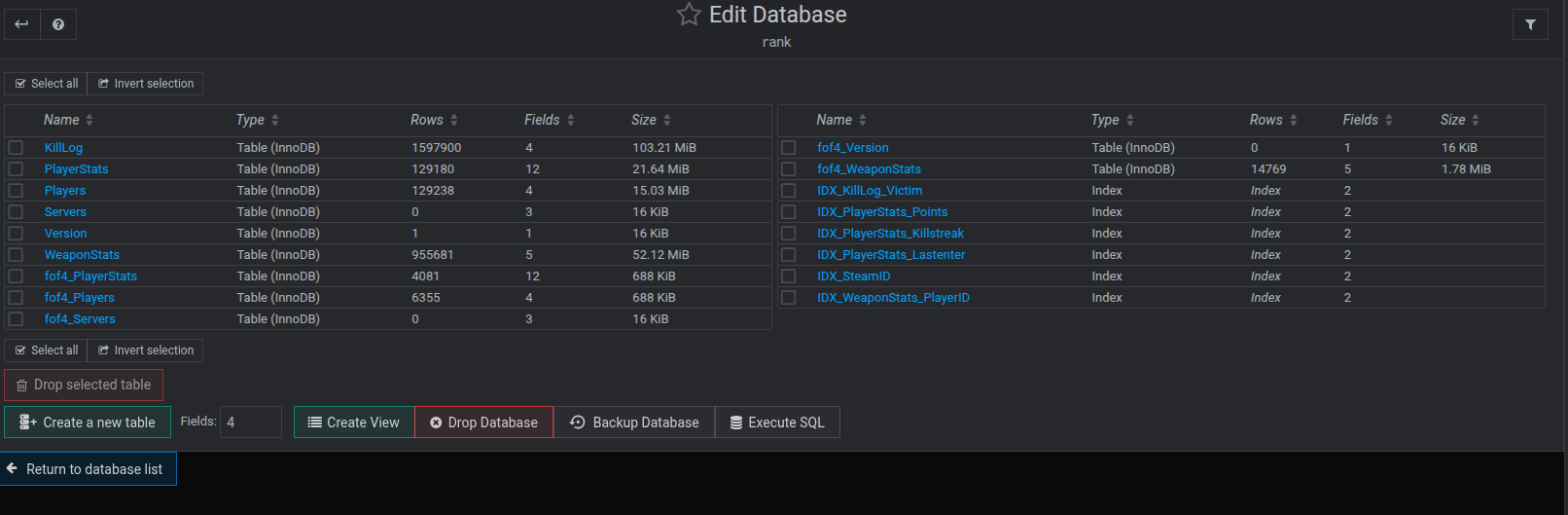

change the default for the affected fields then
using the maria/mysql option in webmin->servers edit the database you will see

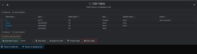

then click the affected table you will see something like

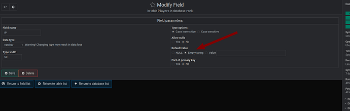

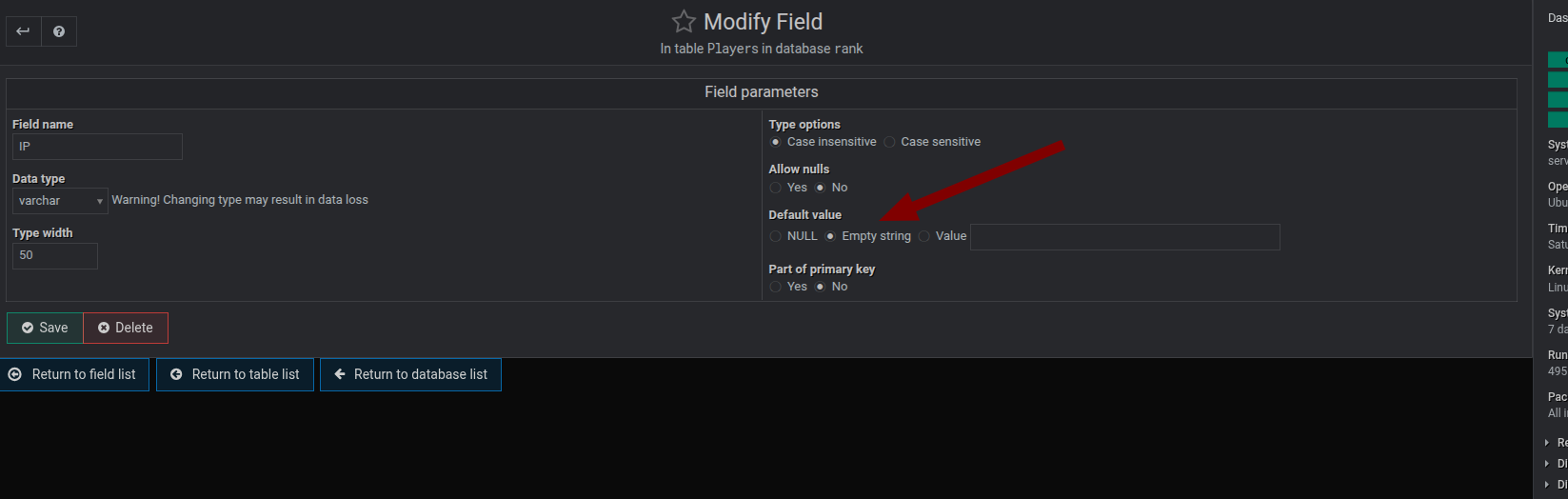

then edit the arrowed section to what you want, tend to set this to null as you can see from the above screen shot then click the field
