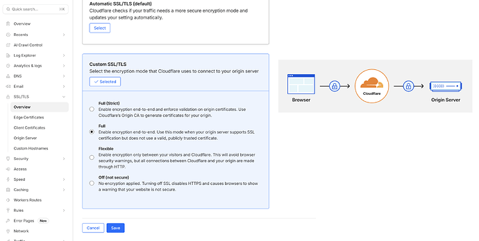

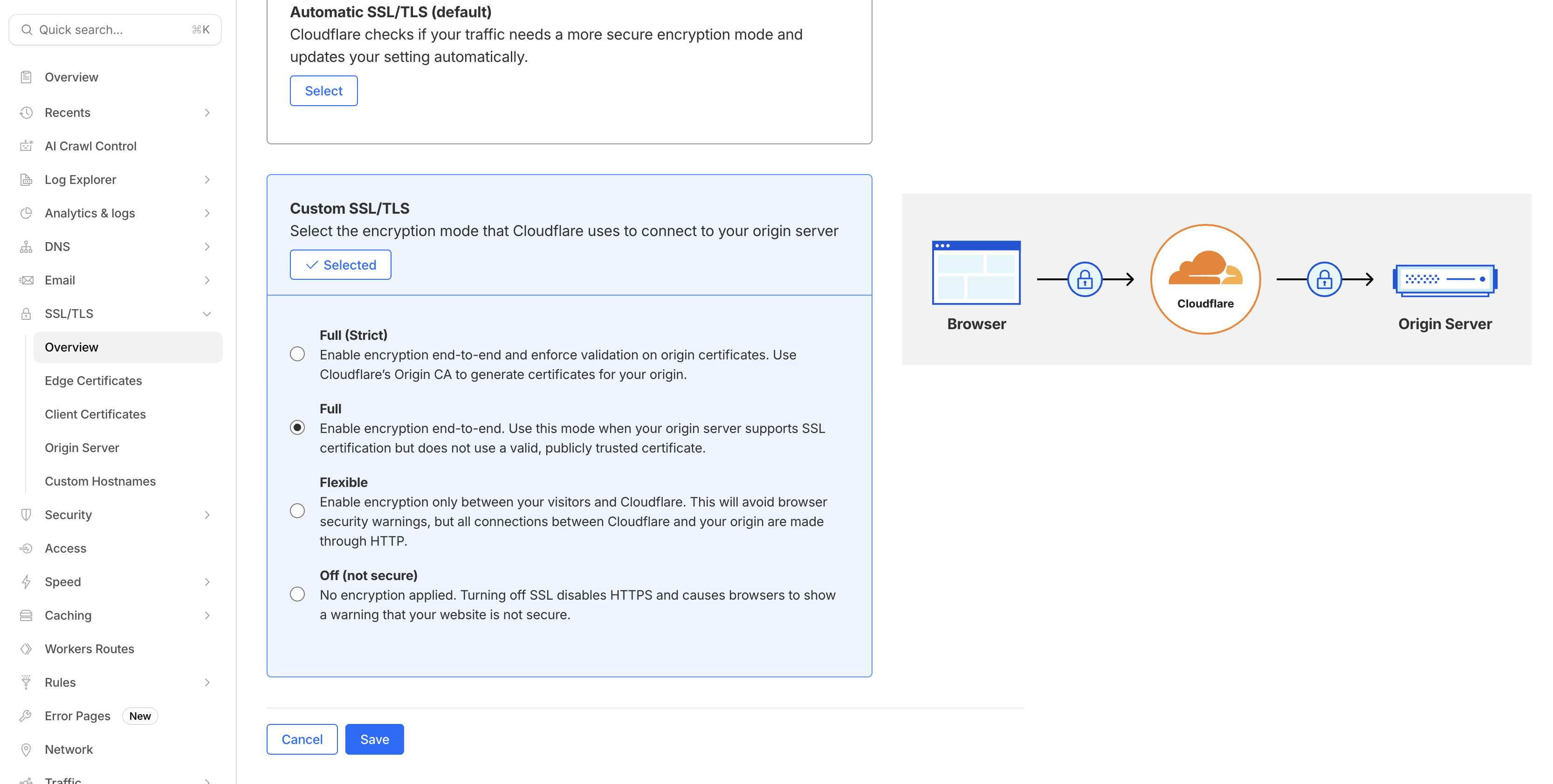

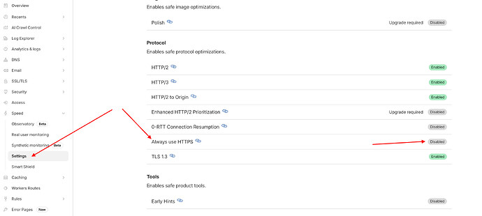

That’s strange. I have over 50 domains hosted on Cloudflare, never had issues with certificate renewal. Make sure your SSL settings on Cloudflare are like this (and also the HTTPS rewrite is off, can’t remember where exactly that setting is on Cloudflare).
Edit: found it:
